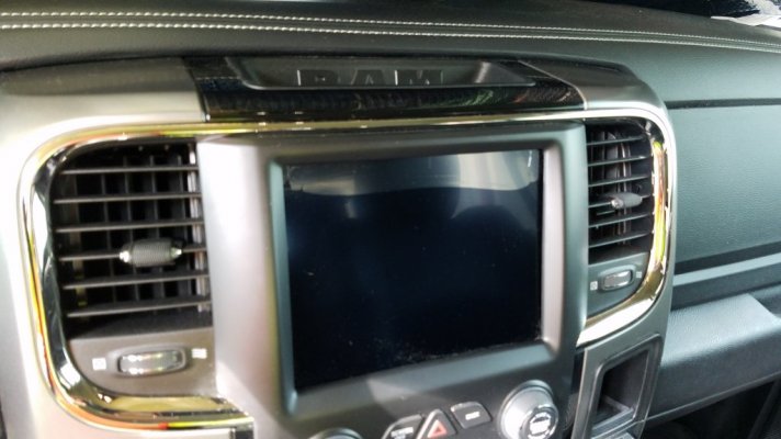

Same here, 2018 with 67k miles. Clock message goes crazy from time to time.43CCFDCF-1347-4BD4-9F11-F6733EDB4427.jpeg
J
Jden45
Jun 29, 2021
25
9
Ohio
Yep that's exactly what happens. Seams like it's mostly limited to the 2018s also. I wish I would've recorded the Temps that the screen got up to. Anyone ever try to?
