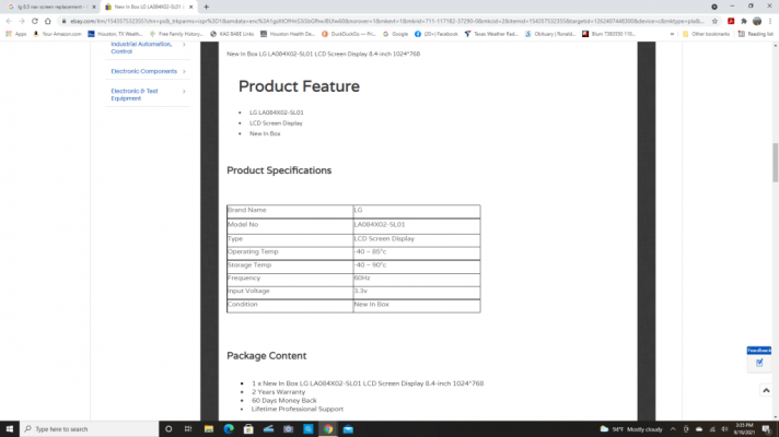

I started a new post "UConnect Screen Fix, I did it" and posted pictures, I fixed it, no more ghost button pushing and by looking at the screen you really can't tell I did any thing to it. Cleaning the glue off was not as bad as i thought, I placed the screen in my closed truck on the dash in the sun for 30 to 45 min and the fishing string sliced through the glue pretty easy. I agree with you CanRebel it's the heat and maybe bad glue. I am in the Houston area and it gets hot as hell here during the summer and my truck is dark paint and interior plus it sits outside 24/7. From reading up on LOCA glue there are different hardness once cured and I would think the glue in these radios is suppose to be semi soft. Saw this on ebay, someone selling a replacement screen assembly, note the storage and operating temps , 90 c = 194 F, pretty sure my trucks interior is pushing that number on some days.

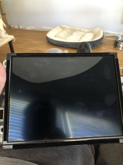

This is out of my 2018 dodge ram 1500 bighorn its the 8.4 4c with nav delaminating bad anyone know a good place to sell it and how much is it worth to sell
