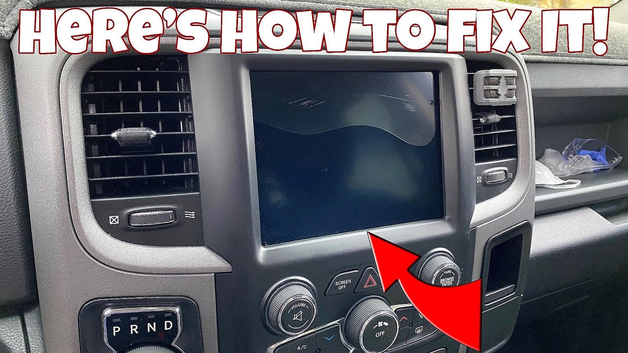

I have the same issue with my 2018 Ram 1500. Suggest you order and replace the digitizer yourself and don't try to peel the screen apart and clean it out. You have to be very careful and it fails to work for some people.
The digitizer cost about $330 from eBay. The part number is: LA084X01(SL)(01) or 4 4C UAQ UAS LA084X01(SL)(02) Touch Screen Glass for 17-20 Ram. Yes, it costs a bit but it is much cheaper than the $1000-1700 that the dealer will charge you.
Below is a link to a pretty good Youtube video on how to do it yourself.

Follow up to my previous post from 9 Sep.
Got the LCD/digitizer in the mail ($350) and installed this weekend. First time was a bit rough. I didn't get the mother board properly seated/connected to the circuit board below it, so it didn't power up when I restarted the truck.
The Youtube video was very helpful but his 2017 Ram 1500 has a different front panel than my 2018. It was a challenge to remove because the 2018 version has two screws in the bottom that have to be removed before you can get the cover off.
Be very careful when you disconnect the LCD from the rest of the radio. There are spacers in the radio to hold the circuit boards apart, and they fell off, into the radio, when I opened and titled it. Lots of fun trying to fish those out!
Recommend you be sure to hold the assembly tightly together after you remove the screws on the LCD, then turn it over and lay it flat on your work bench before you lift off the LCD. Don't tilt it to the side.
Once I removed the radio/LCD the 2nd time I was careful to reseat the connection to the motherboard on the LCD and it worked as soon as I started the truck.
Man the LCD was a mess. Melted glue all over. No wonder the radio was failing. How is this not a Ram recall item?!?
Highly recommend this fix. The dealer wanted $1200-1500 to put in a new radio. Saved about $1000 for a couple of hours of work.
Just hope it keeps working good thru the next hot summer.

Finally replaced my entire digitizer/ lcd assembly last night with an ebay unit. The one I removed from my '18 Ram was an SL 01, which had a bubble covering nearly 50% of the screen area, to the extent that it was ghosting without the previously experienced humid conditions.
The replacement unit is an SL 02, so we'll see how that shakes out, but even the prior SL 01 took maybe 2+ years before anything started happening (maybe 4 years before I got to the point of nearly putting my fist through the screen lol... see, how is that NOT a safety recall?)
Yep, follow that previously referenced YouTube (don't forget the Torx head inside that passenger side "pocket", above the power outlet, to remove the panel). I took my time, but everything went back together without issue (so far).
