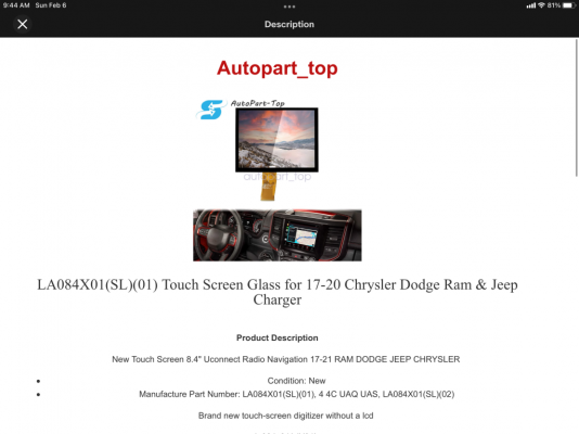

I have 2018 2500 with 30k miles. Screen delaminated, dealer and Ram wouldn’t warranty so I performed repair. Removed radio disassembled used bottle of alcohol and rags to clean gluey substance off of led screen. Reinstalled $40 touchscreen I got on eBay. Screen looks better than factory screen did. Takes about 2hrs, rubber gloves, alcohol and a lot of rags. Terrible that Ram @RamCares doesn’t warranty such an obvious defect. My stealer quoted me 1300 for a new radio.
