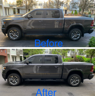

Hi all,
I have a 2021 Laramie with the off road package. I have ReadyLift UCA's and Bilstein 5100's on setting #5. Ever since install I seem to get a "thunking" noise going over speed bumps or pot holes. It only happens when the suspension can droop and I have no issues if the wheels stay planted. Its almost as if the struts are topping out. I have checked for UCA's hitting the coil and also retorqued all of the bolts that were touched during install. I am thinking of dropping down to setting #4 soon to see if this fixes the problem. Does anyone have an idea on what else could be causing this issue?
My trucks measurements for reference:
Front before level: 37.75"
Back before level: 39.75"
Front after level: 39.5"
Back after level: 39.75"

View attachment 476168View attachment 476169
Your truck looks Great!! Ill start by saying the dust shield needs to be cut down clearly stated in the bilstein instructions. You hear a clunk when the suspension is unloading? Is the sound metal like? who did the install?

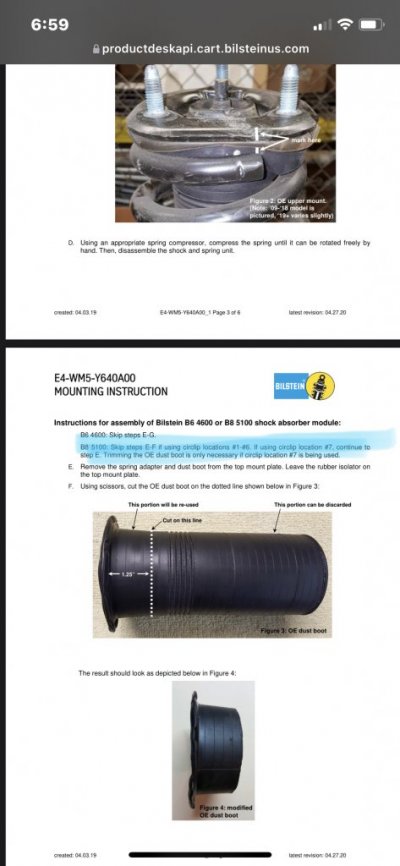

So with this being only on setting 5 the instructions didn’t call to cut the dust shields. I think if you go with setting 7 it called for it which I can’t due to the ORP. I did this install myself and had it aligned a couple hundred miles after install.
The noise isn’t metal like. It’s felt more through the floor board and is just like a solid thunk. I can’t even say it’s clanking because it doesn’t sound like two things hitting each other. It makes the noise when I go over a spot near my house where the rip rises up around a manhole cover a bit. I have to be going about 22-25mph at least to make the noise. It also makes the noise anytime I drive into a pothole no matter the speed. If it’s a decent size pothole it makes the same noise which makes me think it’s almost topping out.

Bilstein instructions that I followed down below. I wonder if the dust shield on mine could be popping over the top of the shock on full droop and popping back off on recoil? Although the noise I hear seems a bit loud for a piece of plastic.7EEA428A-0544-4175-9076-0FE4C2E3AB86.jpeg

Bilstein instructions that I followed down below. I wonder if the dust shield on mine could be popping over the top of the shock on full droop and popping back off on recoil? Although the noise I hear seems a bit loud for a piece of plastic.View attachment 476185
This is where destructions and common sense gets tested. Look at the clip locations and their spacing now look at how much they want you to cut off going from position 6 to 7 ???????
I figured it was odd to max them out on the ORP setting and not cut the dust boot. I do agree with you on that! As for the spring compressor I used two sets of the rentable ones from autozone and stuck 3 of them on it to work it down. I am almost wondering if I didn't compress them enough and bottom that strut nut out? I know its torqued to spec but that doesn't necessarily mean its bottomed out on the threads.
