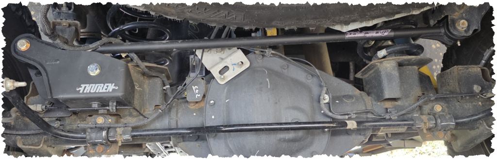

Thuren rear track bar will take care of the Waggle in the rearend, as CJC off road refers to it. It really helped mine.

I assume you both have the Thuren bar installed? Does it make a noticeable difference?
Yes, it does! It's really tightened up the rear end. I consider it one of the best mods I've done for this truck. It's not a direct swap out - Thurens bar is longer than the factory bar and it gets lifted a bit higher so be prepared to drill some holes for the mounting bracket on the left. I installed it on the garage floor but I did end up jacking the left side up and removing that wheel so I could get a better angle with my drill. Oh, and make sure you approach this job, if you do it, with a sharp !@#$%^& drill bit :cool:
