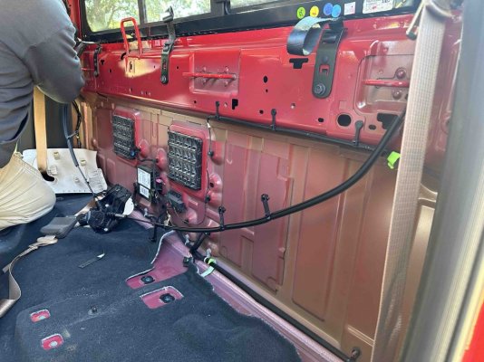

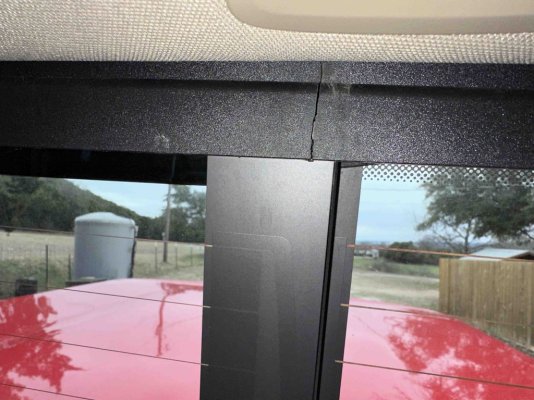

I too had the rear window issue addressed by TSB. I had a lil bit of intrusion headliner, and both sides of my interior slider frame was cracked, but whole assembly was replaced under TSB. Heck, they even came to my house and did the replacement.
OP, if U jump for E Torque equipped, the most important thing U can do in my opinion is keep an eye for any issues ref rear window/chmsl/rear area as the RF hub is back there mounted on wall and you also have the 48V battery back there that does not mix well with liquids. Something to be aware of. Notice pic of backwall showing the Cab vents and the RF hub mounted a bit lower between the cab vents. SO anyone who has a n ewer RAM needs to be aware, not panicked. Posted PIC so PPL know what is there. NOW I have non- E TQ truck, so U see no 48V battery there, which would be behind drivers side.
back wall interior RAM.jpgRear Interior Backlite frame cracked-Friedman-2019 Ram 1500 5th Gen.jpg
  • 23-098-23 TSB Back Window.pdf
