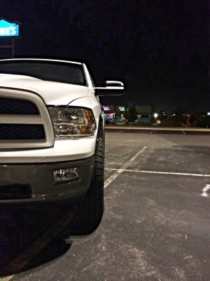

I'm running 35x12.5s on my zero offset 4" zone.. have just under an inch between the knuckle and tire on the backside..

Do they stick out about an inch or so?

Ok ok cool! Thanks! Was hoping they would stick out a litttttle more but oh well. I have some fender flares coming as well. Just waiting lol
