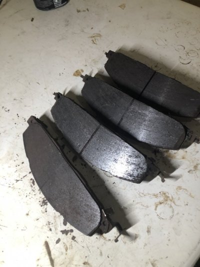

Just did the fronts pads and rotors in the driveway on a Sunday afternoon I went with the best Canadian tire had lol cost about 350 cadets
4xdad
Feb 18, 2021
2,294
2,490
Edmonton Alberta
2015 powerwagon
Rears today 100cad just pads about 2 hours labor both bottom pins were seized got every inch out of them
