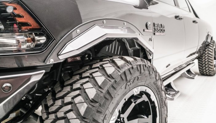

I have a 2015 1500 slt crew cab, I’m a sucker for the Fab Fours fender flares but the closest fit would be for a 2016 2500 model. With their pricing I don’t want to buy and not have it fit or not be able to trim to fit. Any tips on if this would work at all?

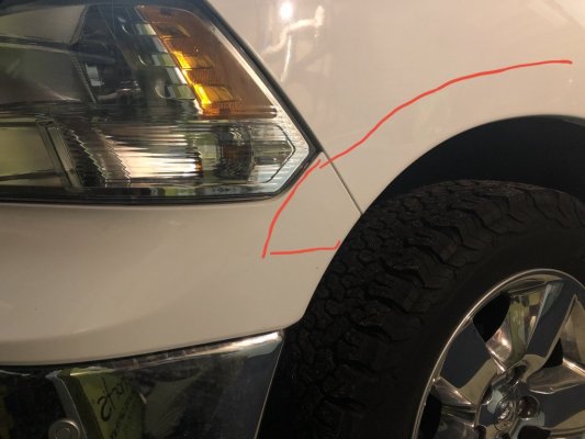

Theres no risk. They will fit just fine. Its all the same metal between the 1500 and 2500. The only thing is the area up at the front bumper…the flare is gonna come up slightly short, kinda like right here…

Theres no risk. They will fit just fine. Its all the same metal between the 1500 and 2500. The only thing is the area up at the front bumper…the flare is gonna cup up slightly short, kinda like right here…
It always looks off to me when they put fender flares on trucks with painted bumpers
Even the chrome ones look off
The aftermarket really dropped a stitch by not making a little section to cover that front
