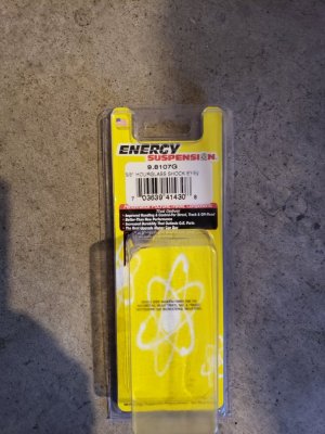

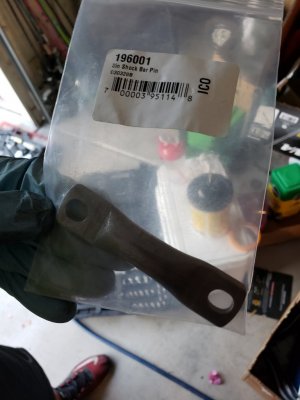

Kurek and Ram1500rsm are 100% correct on the 2wd shocks not lifting the truck.
I used this bilstein part# to match my needs per Maxtrac shock heights info.
I used bilstein 24-062107. This shock is for an extra 2" of lift on the front. Now the second part of the problem is you need a bushing and a 3" tbar pressed into the bottom of the shock so it will install into the LCA. The tbar that comes installed into the shock will not fit the LCA bracket. It's not wide enough.
