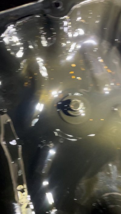

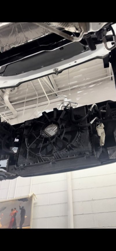

Since low oil pressure and slight knocking noise. Ram technician pulled oil pan and found gold e.g. pieces of rod bearing. All was good claim submitted and a new motor was installed dealer provided loaner for 30 days while the claim process and wtg on motor delivery and installation. I'm in about 6500 miles and one oil change and I'm happy. Lifetime power train warranty saved my ass. One thing to note original motor failure occurred at 95k miles since new motor fuel milage for the first couple of tanks was horrible but has dramatically improved and is back to 30 MPG Highway. The people at Ourisman/Lustine Ram in Woodbridge Virginia are really awesome cant say it enough Thx "D"
