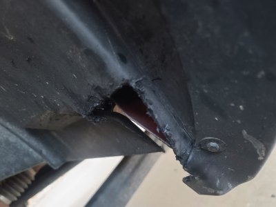

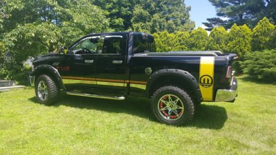

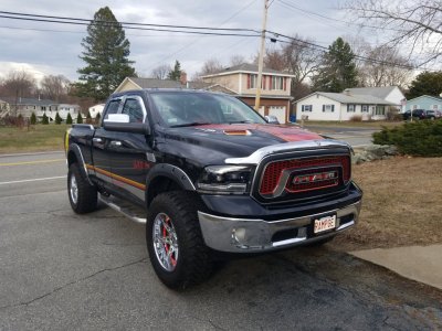

I can most certainly appreciate, and respect 37's and the color scheme. Great looking truck" what I did to prevent any slight rubbing of the plastic wheel wall guard was drill a small hole near the rubbing area take a stainless nail twist a metal line around around it pull it through the hole and tie it to my frame. It pulled it back just enough to get it out of the way. I know Power Wagons have at least a 4 inch lift in them stock, I had to lift mine. I also painted the nail and the wire black so they could not be seen no matter how close you get. Yea" I know it sounds like a bit of work? but the results are stella.Truck 1.jpg Truck 2.jpg Truck 3.jpg
