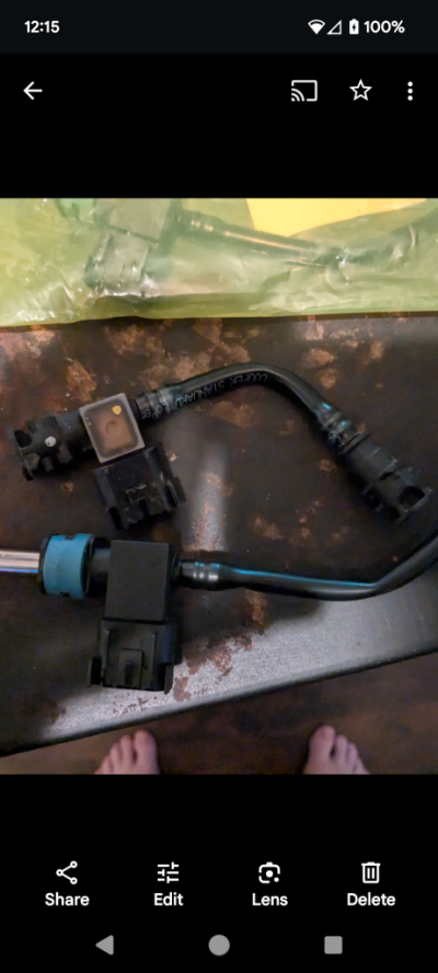

So quick note I have the same vehicle. The 2013 ram 1500 4.7 right now I do have it running. Still looking for the original part but this is what we ended up doing. We ended up cutting the red tip off and mounting it to the new sensor. Pictures enclosed. This is the only code that I'm getting right now. Which is telling The computer is diagnostic it and hopefully it turns out. I'm still looking for the original part at a junkyard. Anywhere in the United States but for right now it is running. Seeing the fact that nobody answers back of any idea how to fix their vehicle. 1000009903.pngng seems to be running okay. Check engine light went out but I do have it coming on here and there. I have got a lot of miles on it yet. The code that it throws when the check engine light comes on is1000009949.png1000009948.png1000009863.jpg

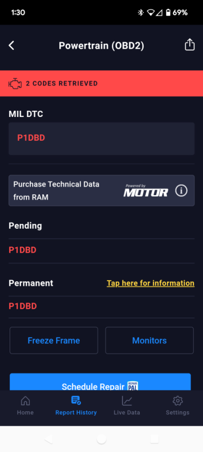

I know you're frustrated. I'm doing the same exact thing. Same vehicle ram 15 00 2013 4.7 tradesman flex. This is what I did attached pictures. I ended up buying one from Amazon when I did hook it up. It sprayed gas everywhere where the red clip is supposed to attach. But the vehicle did turn over but ran rough. Took the new one. Cut off the blue tip. Took the old one cut off the red clip. Mounted the red clip onto the blue one. Put it on the vehicle. It is running. It is only throwing one code right now which is the code that says the computer is checking the system. I'm still in testing mode. This has only been a week right now it is holding. But I'm still looking in junk yards for the real part pictures. Picture one is finished. Product, picture two was my sensor versus the new sensor. We cut off the red clamp cut off the blue on the new. We heated up the tubing on the new shoved the old clamp into it and for extra measure we put the pipe clamp on it. Vehicle started right up vehicles running. I've only been doing short runs like one to two a day and a large circle around my neighborhood which is a 13 mile. It starts up it runs it's doing it. It's not overheating not throwing any other sensors but the one
P1DBD
Ken226
Mar 12, 2017
2,293
5,933
Washington State
Did you clear the codes before test driving it, or is the code from before you replaced the part?
