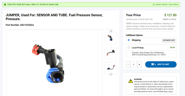

I went to the site I used to determine that the 2021 Rack/Pinion would work in my 2013, and entered your 4.7 liter truck info, to see what it lists as fitting.
Here is the site. McKinney, TX Ram:
To condense a long story, into short form, They show 3 part numbers for your truck. You can see at the top of the listing highlighted and in green text, that it indicates these parts fit the 4.7L truck.
First, the oldest is 68210330AA. It appears to have been superceded by 2 newer part numbers:
Next: Is 68210332AA, which is the 2nd newest version. It was superceded by 68210338AA.
Since most every other site ive seen, including Ebay lists 68210332AA as fitting the 5.7 Hemi, I doubt there is any difference between the Hemi and 4.7 fuel pressure sensor.
Of course, this assumes that this is actually the part you need, and that my research has been correct. I've been wrong before.
All of the aftermarket sensors from Ebay, Amazon, etc, show them as being direct replacements for OEM 68210332AA. So, most likely the aftermarket versions will work with both the 4.7 an 5.7 Hemi.

Have you looked at yours and compared it to the pic of the sensor McKinney Mopar says fits your truck. PN# 68210332AA:

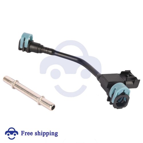

This one, that can be purchased pretty much anywhere, including on Amazon:

So far there have been plenty of indications that the 4.7 and 5.7 use the same part# fuel pressure sensor. I think Steve is just going to have to accept that there are no sure things in life, order the thing and see if it fits.
After the last few years of inflation, the price of the OEM part is barely equal to two ****** meals at McDonalds. At least, in my neighborhood with a 20$ + minimum wage. The price of the aftermarket ebay part below is like, 2 lattes at starbucks and a gas station burrito.
The aftermarket ones on Ebay also list the part as fitting both the 4.7 and 5.7.
