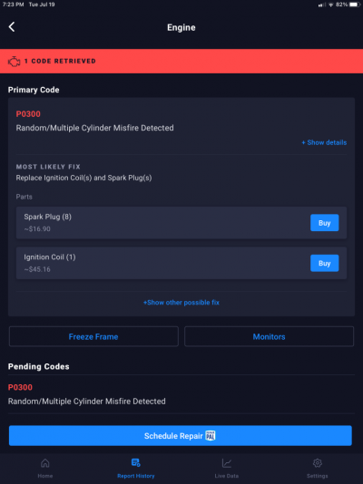

started acting up a few days ago. Got a blinking CEL going down the hwy and then no CEL at all. When you first put her under a load she is as strong as ever but after about an inch of throttle she lays flat starts missing. When checking the codes i get a P0300 multiple cylinder misfire but it will not pinpoint which cylinders are acting up. Clear the codes start it up no codes, drive down the road its doing the same thing and no CEL. Head scratching for sure. Plugs coils injectors sensors cats all less than a year old. No back firing or popping she just want take the fuel. What's new? Fuel pump, cam position sensor. Everything else is less than a year old.

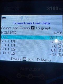

this is while running

That is a really low vacuum at idle, it should be significantly higher.
Other thing I see is spark advance at 110 degree? I can't even see how it can run like that.
Have you checked the grounds? There is a black/blue tracer wire (at least it was that color on cars) that is the sensor ground and it will cause all type of havoc.

She finally threw this while at idle
How could this just happen at once multiple misfiring? Every plug coil and injector are new and have less than 600 miles on them. Could it be bad gas? I got a small leak detection code right before all of this transpired plus my low fuel light came on.

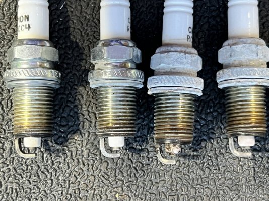

Alright I just put 8 new plugs in. Champion Copper. That truck screamed. Ran wonderfully. Got out and grabbed a coke I let it idle while in the store. Got back and leaving the parking lot it stumbled, not nearly as bad but it did. The CEL flashed a few times and stopped. Then it cleared up, stumbled again and cleared up. Wow
