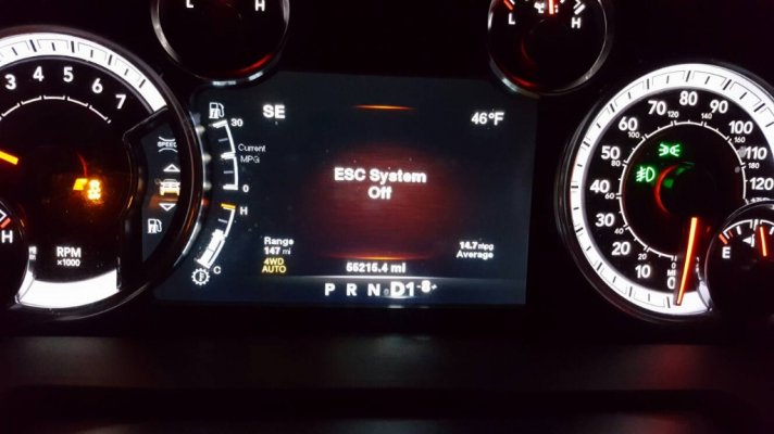

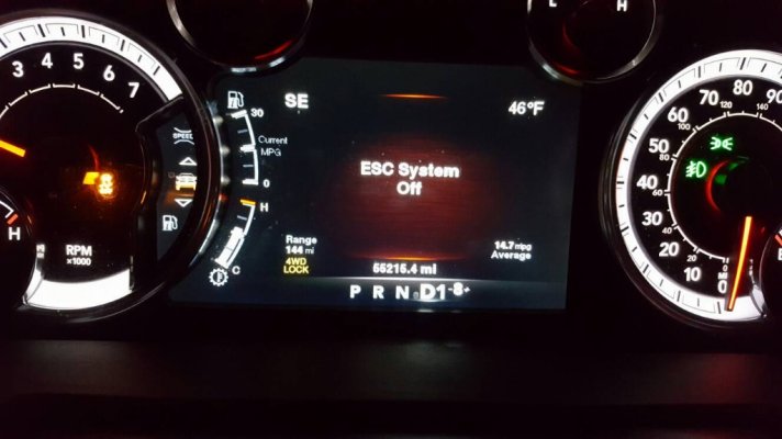

What is the difference between these two?06f0b9a298d44d760e44a43471cb3236.jpg36a875027df16720a7ddb0e6b459fabf.jpg

Does that happen on your EVIC just by turning on 4wdAuto or 4wdLock? That definitely doesn't happen in my 2013.

Manually comes on with the long press of the TC button
Sent from my Pixel XL using Tapatalk
Yeah, didn't happen with my 2013 either.
Sent from my SM-N920T using Tapatalk
Oh gotcha I thought you were showing that it came on whenever you turned on any 4wd mode.
4 low is the only mode that it automatically turns off ESC
Yea that's what I thought...That's why I was confused haha

And unlike my 2010, I haven't seen ESC turn back on at certain speeds.
Probably nothing between auto and lock both will automatically turn off when you reach 40mph. In 4WD LO they know you can't get much speed so they allow it to stay off until put back into lock, auto or 2WD. I have read that esp off never truly allows being fully disabled as ESP and T/M are written in per the government rules.
It is possible that they changed this on newer models since I see you stated yours doesn't automatically turn off. Mine most definitely will with too much wheel spin.
