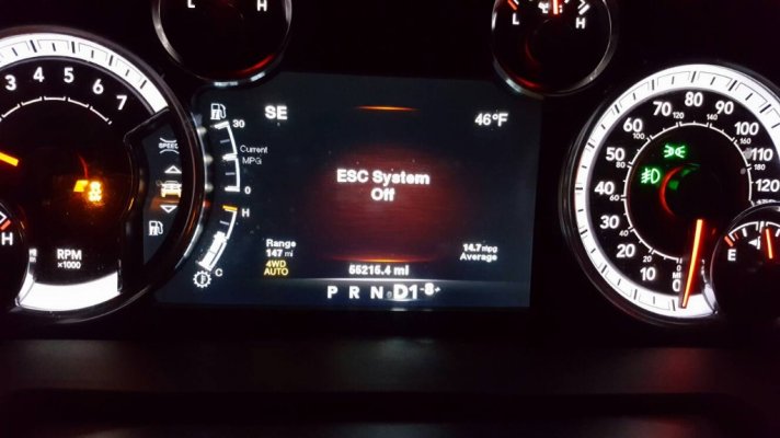

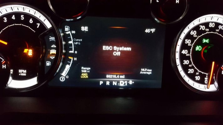

What is the difference between these two?06f0b9a298d44d760e44a43471cb3236.jpg36a875027df16720a7ddb0e6b459fabf.jpg
Sent from my SM-N920T using Tapatalk
So, wait for the next snow storm, and find a vacant lot. Lock that baby in 4 low, and wait for the message on the dash. Next, hammer the throttle and throw that truck around in a donut and see if the traction control takes over........It will. That will get you in a pickle when off road and you need to slide your truck to get aligned with an outlet to a sticky situation. Those that are not having problems with this transfer case are lucky that they don't really need 4 wheel dive. They only use it at their will. Those of use that have been USING 4x4 trucks for the last thirty or more years understand that this transfer case sucks.
I do 4wd drifts all the time. As long as wheel spokes stays below 40, ESC remains off.
Wheels get to 40 in a hurry on ice and snow.........Traction control and ESC are for morons.......Period.
