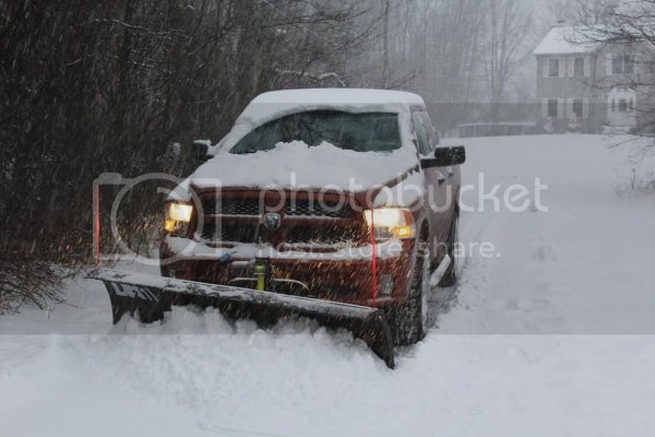

1381545565211400_4237631057592940345_o_zpsfjitwc5i.jpg Im glad I have the 44-45 case in my Express.I wonder if the 44-44 would give me trouble when Im plowing.
How do you like that plow was looking at it the other day for Ram 1500. What size blade you can pm me so we don't completely hijack this thread.

Of course, it would, probably better even. However, you should not be snow plowing with a 1/2 ton pickup.. even more so, one that specifically says not to. Shame on you! Hope you don't get your vin blacklisted :favorites13:
I would bet more people have plowed with a 1500 than 2500 and above until the last 10 to 15 years. They used to be how many many jobs got done. The 1500 is just fine for that size plow.
