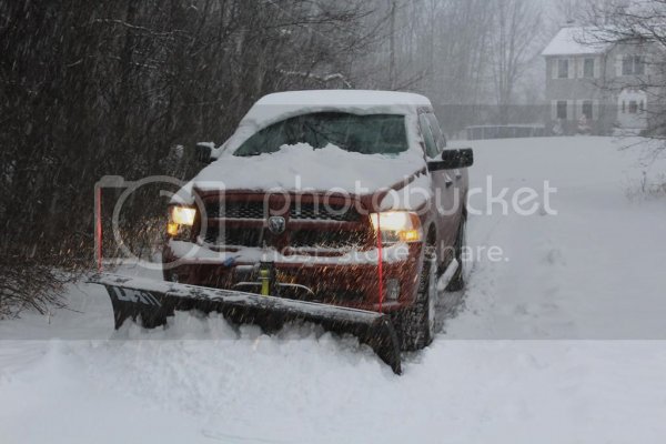

1381545565211400_4237631057592940345_o_zpsfjitwc5i.jpg Im glad I have the 44-45 case in my Express.I wonder if the 44-44 would give me trouble when Im plowing.

1381545565211400_4237631057592940345_o_zpsfjitwc5i.jpg I'm glad I have the 44-45 case in my Express.I wonder if the 44-44 would give me trouble when I'm plowing.
Of course, it would, probably better even. However, you should not be snow plowing with a 1/2 ton pickup.. even more so, one that specifically says not to. Shame on you! Hope you don't get your vin blacklisted :favorites13:
