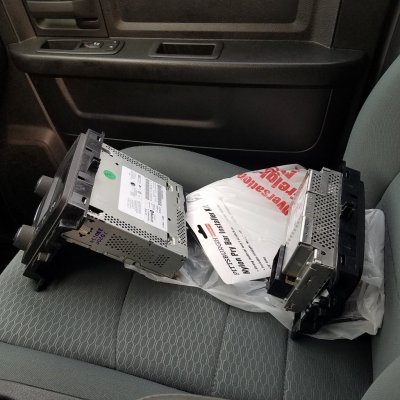

Front view they are identical, on the back they differ. The original radio is elongated the new ones back is pug nosed.
The new one has all the same plug-ins ,hooked up and mounted like it was cool. Turned the power on and the radio works just fine EXCEPT it has NO sound, notta zero. I called Uconnect and did a reboot, checked the amp fuse it all looks good

The radio on the left is the original, the right is the replacement. They look quite different

No problem on the elongated RA2 verses the flat, they work the same. If the radio needed the anti theft code, that would have been the first thing you saw when you installed it.

Hello everyone, my second post here. My humble apologies if I get long winded.
I had a 5.0 RA2 Uconnect radio go kaput on me. I wanted to replace it with the same exact radio pt# 68226685AB. I have a rear camera, siriusxm radio subscription, hands free Bluetooth. It does what I need. I ordered a replacement from infotainment.com $522 pt# 682711367AC. I learned today the original radio part number has been discontinued.
I do have the anti-theft code for the new one. Infotainment guaranteed it to be pre-programmed and compatible. All I want is for it to work & perform as it did when I bought it, no more no less.
Any guesses on why I can’t get any sound? Bad new radio? Maybe the anti-theft code? Any help would be appreciated. Thanks in advance
