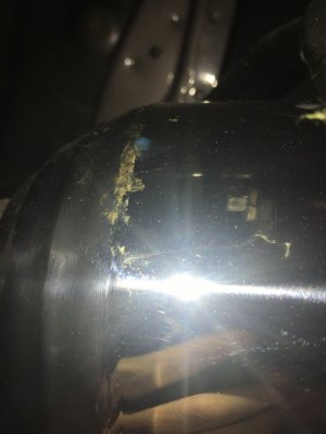

Carven polished 5” slanted. On my 2nd set bc I had a very slight rust around the welds and they replaced for free no questions asked.
That’s odd, I figured there wouldn’t be no rust if they were made of stainless steel. Hell, for 200 bucks a pair they should be. Glad Carven made it right for ya.
I figured since their mufflers are stainless that the tips would be too.
Other than just wanting bigger diameter tips, that was one of the main things that convinced me to buy the kit was because I thought those tips wouldn’t get all rusty like the stock tips could over time.

There shouldn’t be, they state 304 which shouldn’t rust for a long long time if at all. Which is why they have a 100 yr warranty. All they asked for was pics and I had new tips in a few days. I think they said there was a batch of tips that had contamination and my guess would be the welds as it was barely anything and only at the edge of the welds... maybe a mixup of not great 304 was used in welding or maybe they didn’t use the correct 308 fill who knows.
There mufflers are 409 SS I believe which will rust after a few years. 304 is better and 321 is the best but hella $$.
Here’s a pic of the rust on the ones they took back.
