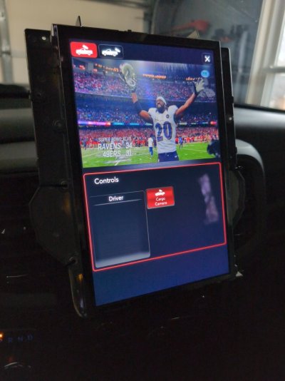

Mine works, are we talking something different then this?
