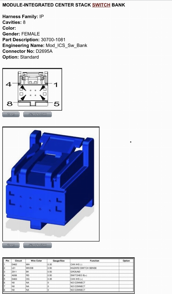

A conversion Y harness needs to be built for the HVAC/Hazard switch controls. The two circled connectors are the same 8 way connector that contain the same circuits, just with different pin locations, and they both need to be plugged in. yuEl6tW.jpg The red circled connector is the original one that the factory dash harness plugs into. Here’s it’s pin layout- z5gnK5e.jpg

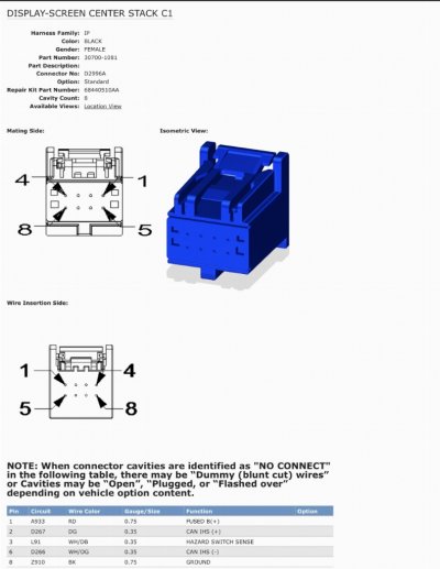

Here’s the pin layout of the purple circled connector on the display screen- dzz3c8o.jpg

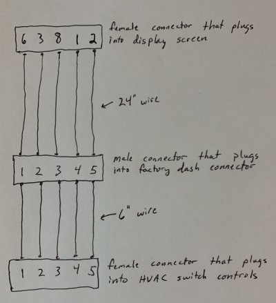

You’ll have to build a harness that plugs into the female 8 way dash harness connector, takes those circuits, and branches them off to the appropriate pin locations on both circled connectors. HqoOBlH.jpg

Parts to make the harness:
(1) Male 8-way connector- https://www.digikey.com/products/en?keywords=309681081
(5) Male terminals- https://www.digikey.com/product-det...tors/2-1419158-5/17-2-1419158-5CT-ND/11492481
(2) Female 8-way connector- https://www.digikey.com/products/en?keywords=307001081
(10) Female sockets- https://www.digikey.com/product-det...amp-connectors/1393366-1/A101883CT-ND/2700940
Tessa tape
20 AWG wire

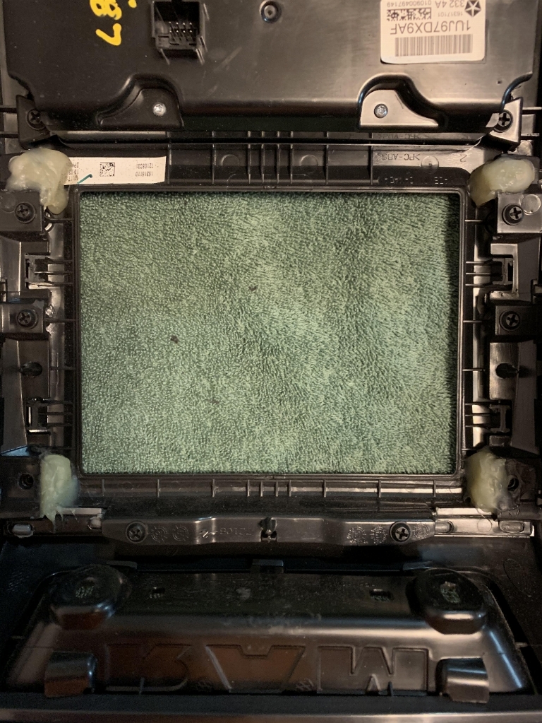

Normally, the radio gets mounted to the dash opening, and the center stack gets clipped to the dash and the radio. With this two piece radio, you’ll have to just stuff the radio module into the hole sideways,and leave it laying in the dash. I zip tied mine down to the tubular dash frame with a long zip tie. The display screen will have to get screwed to the back of the center stack radio bezel. To do this, you have to build up some mounts. This is where you can get creative if you want find a better solution. I used Loctite plastic bond, built up the mounts, sanded them with a dremel, drilled the holes, and screwed the screen down. First, I cut the four circled clips off and remove the two screws the arrows are pointing to- fV99GnC.jpg

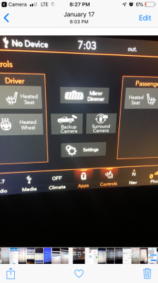

One thing to note, the UAQ radio also has the "red" fakra input connector from the CVPM. The UAQ radio also shows the "Surround View" button in the Controls section when the CVPM is activated in the BCM so it may be possible to get it working with the UAQ radio but maybe not with all the camera angle controls that the UAV radio will have.

It could be possible for the UAQ. I did get the surround view control to show up when I had my UAQ, but I couldn’t get the backup camera from a 2019 HD to work no matter what settings I tried, makes me think it can’t happen on the UAQ.
I tried this on my 2018a few weeks ago with uaq radio and the icon showed up a day later etc .
When I pressed the soft key it displayed my backup camera which is the one from the factory .
I wonder if the camera you used didn’t work because it wasn’t plugged into the cvpm?
Or does it even plug into the cvpm?

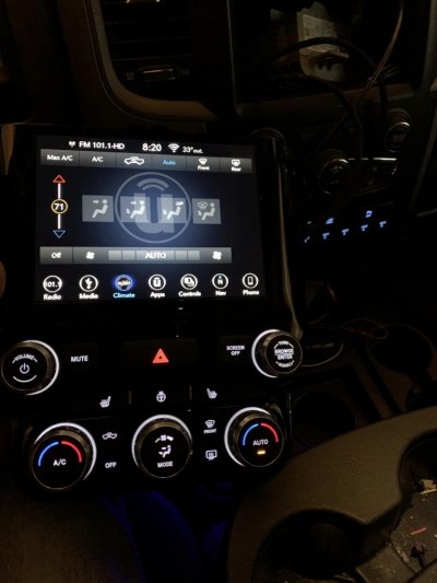

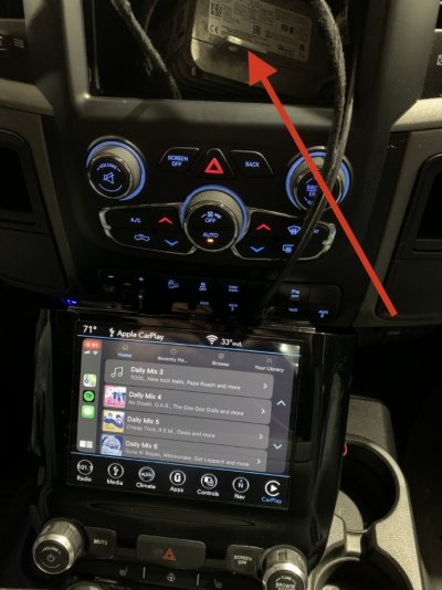

Got any pics of it installed and powered up ?
Here’s a pic when I was testing it with the 4th gen HVAC controls. Note the module sitting in the opening sideways. I just tucked it further back in the hole for final install- el2qmEV.jpg
Here’s a pic when I tested the HVAC controls on the 5th gen radio bezel- AeFHSSj.jpg
The 5the gen bezel would have to be trimmed with a dremel to fit the 4th gen center stack, and it also has white backlights that contrast with the blue backlights on the lower switch bank.
The camera I used is the one that plugs into the red fakra connector on the back of the radio. The UAQ radio that I had would take a about a day, and multiple drive cycles for the backup camera to work any time I unplugged the radio and plugged it back in. It’s very well possible that I just didn’t give it enough time for it to work. I just sold that radio, too, and I should have just kept it to test all this out with both radios...
