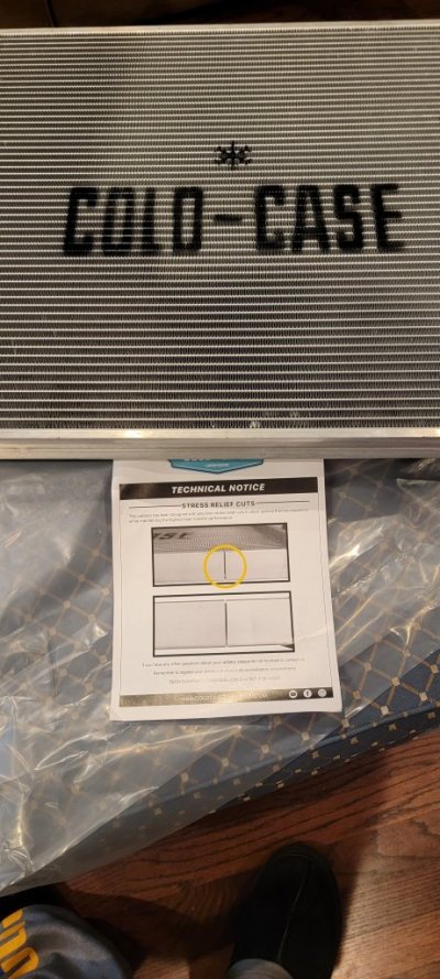

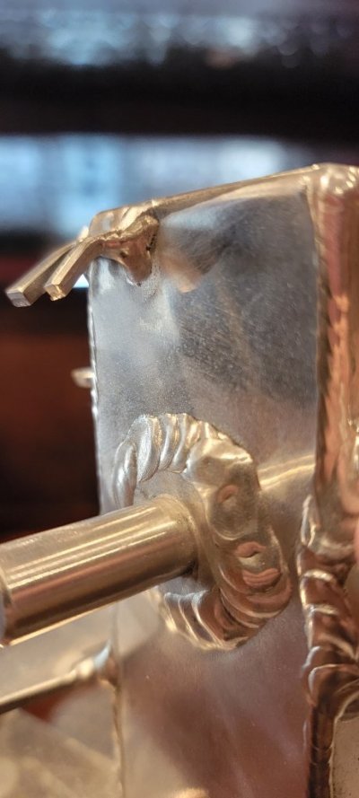

As promised, here's some pics from the cold-case aluminum radiator from americantrucks.com. I'm not impressed. Pics below. There's a bent bracket, it did not come with hoses as mentioned on the website, and there's some welding paste or something that I was able to rub off with my finger from inside the radiator cap and you can see it on the cap interior as well. They also put a slip of paper in with the radiator stating that there's a thermal expansion cut on the bottom, which wasn't there. Was it forgotten or not needed? If it's not needed, why include the paper??? I started a chat with American trucks. Just stated that it was received damage. They asked if I wanted a replacement or refund. I said replacement, which I'm starting to think was a bad idea. They said they just emailed me a prepaid FedEx shipping label and will send the replacement as soon as FedEx scans the return. Pics below.

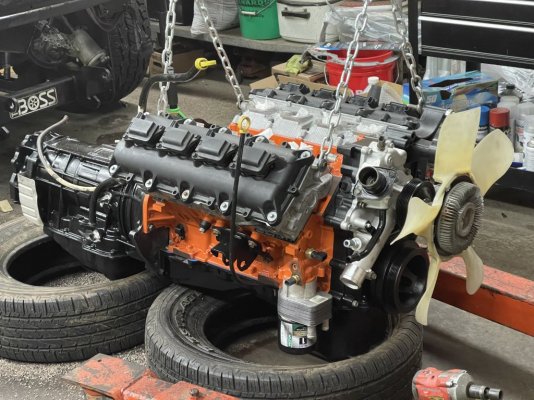

I’m in the process of finishing up a 6.4 swap in my 2011 ram 1500 with 3.92 gears.
DD9E674E-7DC3-40AF-82D5-80345728D8FB.jpegThe engine came out of a 2017 charger Daytona 392 with 20k.
I tore it down to the short block inspected everything. Put in a Comp cams stage I HRT cam, mds delete. ARP head studs. I installed a 6.2 hellcat oil pump, outside dimensions are the same, but they machined the case to put in a wider pump gear to move more oil. Swapped the front cover from the 5.7, new water pump, 180 degree stat. 2008 jeep srt aluminum intake manifold, only need a 90 degree boot to connect to my k&n CAI. I was going to try to make the srt manifolds work, but bought bbk shorties. Then 1 7/8” eBay headers with Y pipe, (under $400, worth the gamble from what I’ve read, plus the material and welds are so much better than the BBK shorties).
The 545RFE got a transgo pump pressure upgrade to 160psi, and the valve bodies got some goodies replaced aswell. I have the Circle D 11” 2600-2800 stall converter. I also had custom 1/2 inch return lines for the tranny cooler made.
I’m hoping to have everything buttoned up in the next couple of days. My tuner here in West Michigan wants me to tow it there so he can flash it, break in the cam and tune it. I hope she screams!!

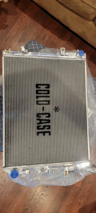

Just got my replacement radiator. I dropped it off the return at FedEx Monday night. Started a live chat Tuesday with americantrucks.com since I didn't see am email with the info for the new one like I was told. He said the new one wouldn't be processed until the return was processed. He gave me a $25 credit, that I won't use, good for a month, due to the misinformation. Tuesday afternoon, I got a new email that the replacement was in route lol.
Welds look consistently better on this one and no gunk to be found. No damage either. Good to go.

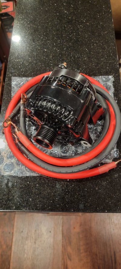

Ooooh that's niiiice. Didn't really need their big3 wire since I have 1/0 big3 currently, but just got theirs just incase I wanted to slap some more wires all around and their price was good on them. Funny thing is, they advertise 1/0, but actually sent 2/0, so even better. I'll definitely use theirs for primaries. 20220215_173933.jpg20220215_173722.jpg
