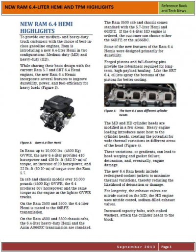

Does the HD 6.4 use forged rods & pistons?
theviking
Apr 7, 2014
1,177
605
Depends on who you want to believe. FCA literature says it does use forged pistons. At least one engine builder stated it was in fact not forged after a teardown. In either case their is additional material (20%) above the top ring land and the compression is lowered to 10:1. Both of which will aid considerably in a boosted application. Rods use a forged powdered metal design but utilize a full-floating pin. Keep in mind the Hellcat also uses a powdered metal design so it's not necessarily an issue although I don't know anything about the practical HP limits for the 6.4 rods. The HD block and heads are essentially Hellcat parts so you're not likely to break anything easily.
The biggest issue I've seen with the BGE (HD) motor is the factory cam and MDS lifters. At least in an NA application. According to Modern Muscle Xtreme the geometry is such that you would have to swap it for a custom grind as none of the existing 6.4 SRT cams will work. Not necessarily an issue on a FI build since the factory cam seems to be boost friendly. But on an NA motor that would get expensive quickly.
