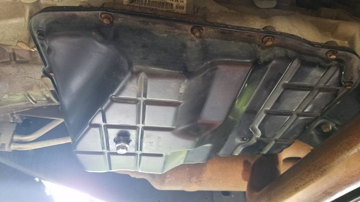

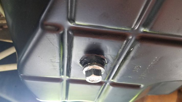

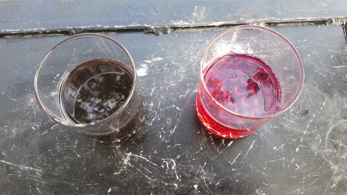

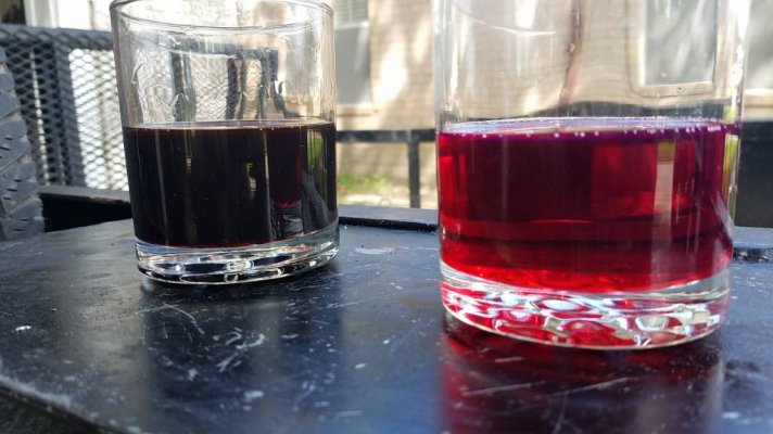

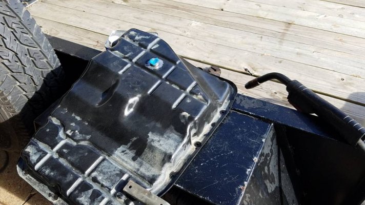

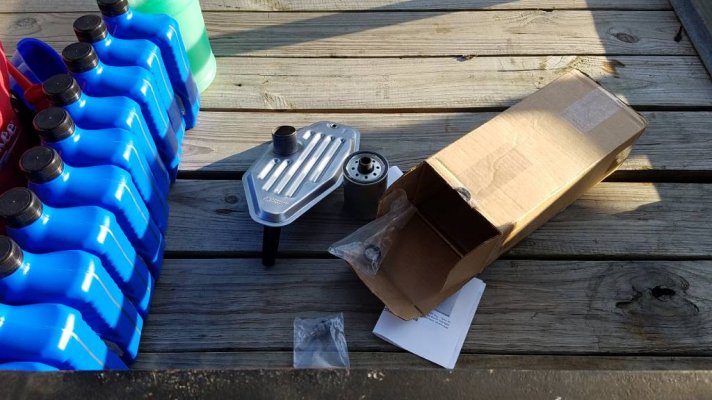

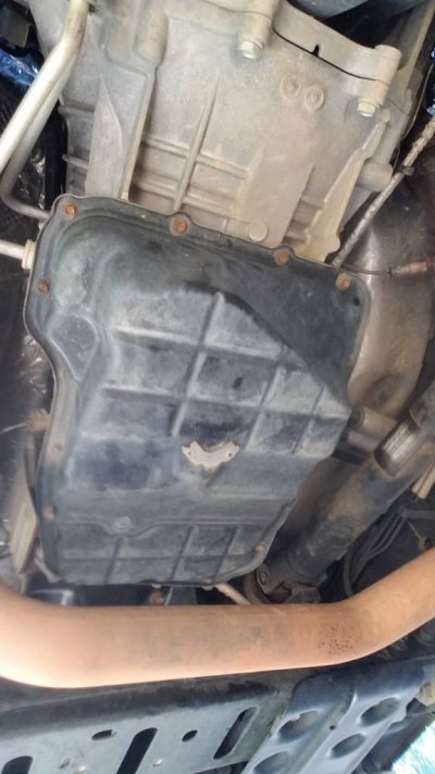

Well with my truck having 61,380 miles I figured it's time for fluid and filters change on my 66 RFE transmission.

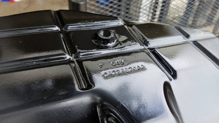

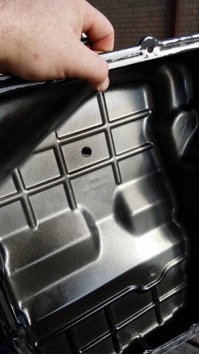

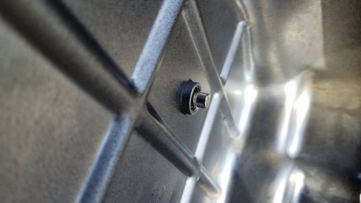

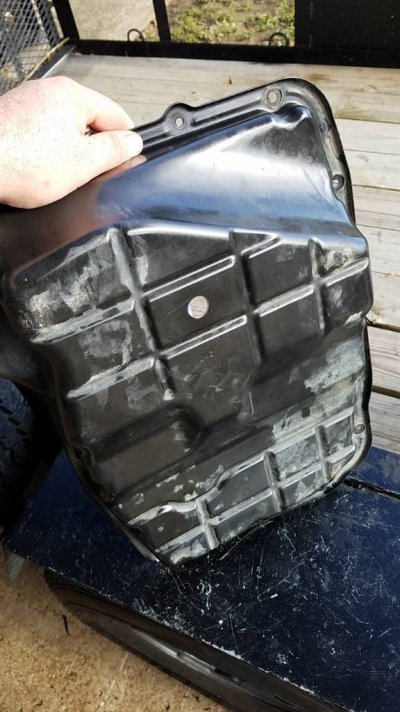

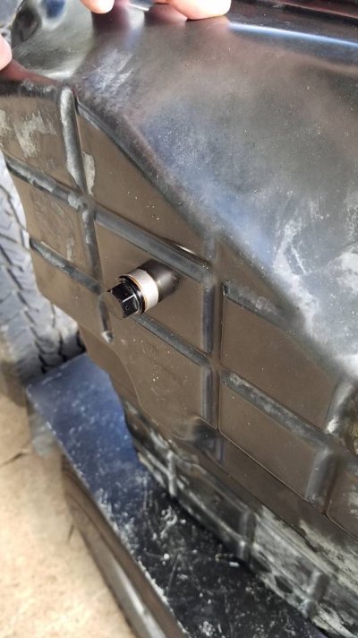

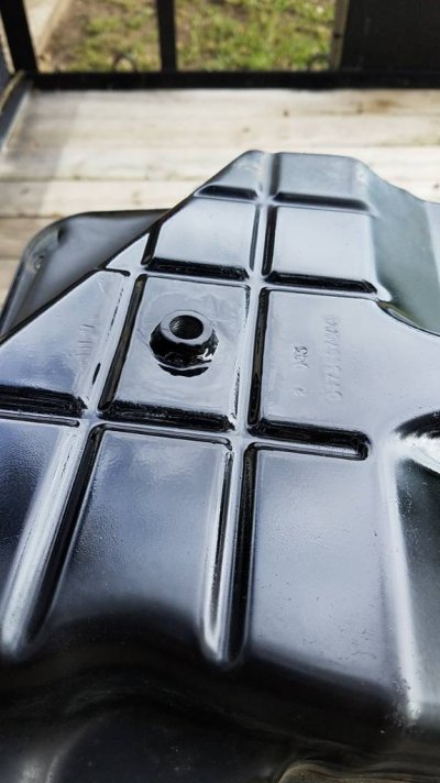

I also wanted to add a drain plug for easy of changing later. I welded a plug in.
I'm currently typing this up while waiting on RTV to dry because dummy me used the Permatex Automatic Transmission Gasket Maker #81180 and it states to wait 24 hours to fully cure before filling with fluids.
That will be 12:30 tomorrow. lol

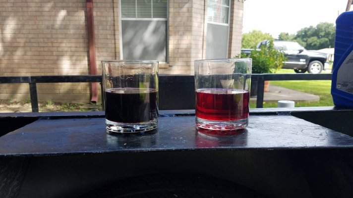

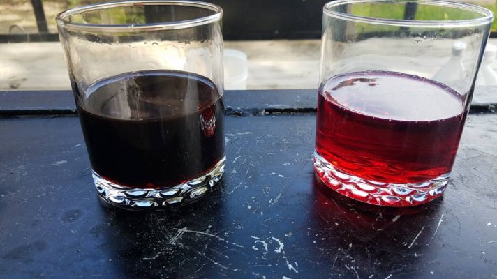

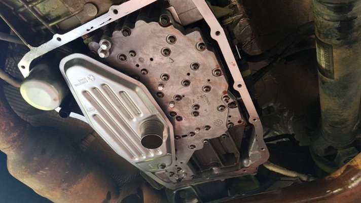

I'm glad I decided to do this as the factory fill was quite dirty and dark. It didn't smell much different than the new fluid but it was dark.

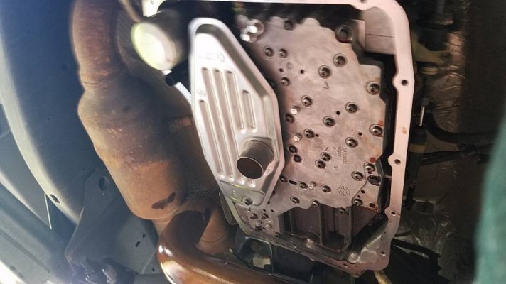

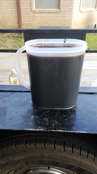

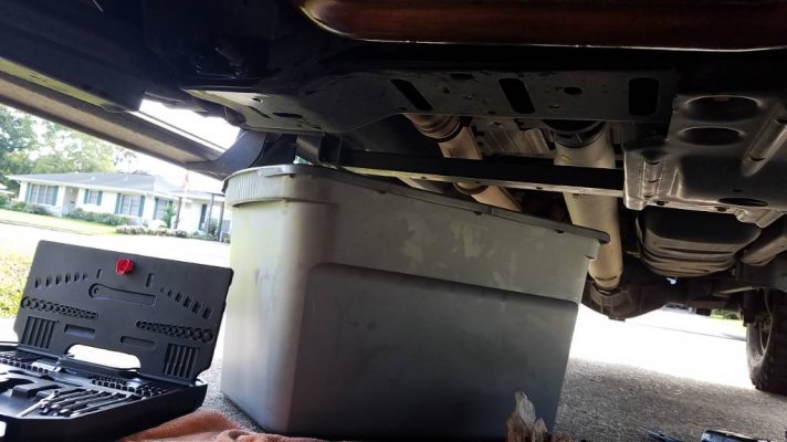

I let it drain for about 3 hours with the filters out with the front of the truck slightly higher than the back.

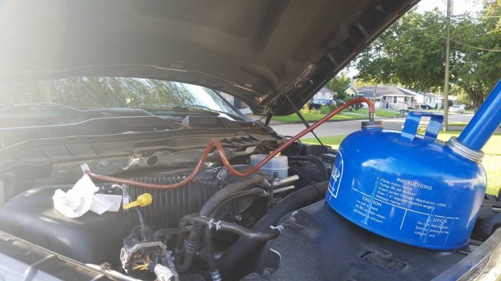

After I had everything put back together I measured exactly how much fluid had come out. To my surprise it was 10 quarts. To my knowledge the transmission only holds 12 quarts total. I was only expecting 5 or 6 quarts to come out.
It's a good thing I bought 10 quarts of Super Tech ATF4 which was all they had at Walmart when I went about a week ago.. I figured I would have about 4 quarts left to put 2 quarts in my transfer case but I guess I will wait till tomorrow after I fill transmission so then I can go buy 2 more quarts for the transfer case.

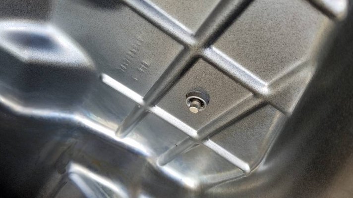

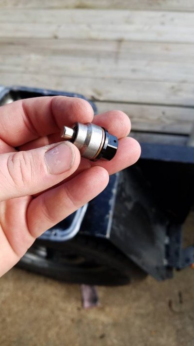

Here are the pictures I took. The drain plug worked out great. I plan on draining what will come out every 10,000 miles and filling back up and then only cracking the case every 60,000 miles to change the filters.d787958c36fb6fb38619d2d307b4bd4a.jpgced0091d158195be8fc0994d58f9fc67.jpgb6145da7af1db5985c1f8d61856b8347.jpg70418bc1c679552cc4dff5db0cd11cf4.jpg7e1f0eed35eaeca4044849926330c2f2.jpgc5f28a97eb359891c5e1cdebcb7e4ea5.jpg4d2daafe6bf82413391c02c23913f817.jpgef0a44f910d16e70d6814b0b0e4979bd.jpg8ec97d21285f3ce5c4030740c6753f4f.jpg

More pictures.
What are your thoughts on about actually waiting the full 24 hours for RTV to cure?
Below is a picture of the front and back of the package of the RTV I used.

Is the oil being that dark normal for 61,000 miles?

How much towing/heavy hauling have you done? It looks normal to me, as the last trans I did was at 70k and it looked about the same, still smelled new though.

I would say it's normal for it to be that dark at 61k because your truck is a 2500. The trans is always working more than a 1500 because it weighs more. If it were me since you have the drain plug now, I would do a few drain and fills to "flush" it so to speak. Should be about 6 quarts from drain plug.
Your fluid is exactly why I think FCAs "normal" service interval of 120k is crazy.
Nice write-up by the way!! Where did you get that drain plug?
2018 2500 6.4 4x4 4.10 Amsoil SS 0w-40, Softopper
Black Rhino Armory 18x9 +12mm
Cooper Stt MAXX LT295/70R18
2016 Durango 5.7 AWD 3.07 Amsoil SS 5W-30
1996 Nissan Altima 2.4 Amsoil SS 5W-30
I tow 3000 lbs of golf cart and trailer about 10 times a year. I tow 8000 lbs of lowboy and tractor about 2 times a year.

Nicely done. Still on the border between welding in a drain plug or going with aftermarket cover. I was planning on doing a video on this in the future.
I just couldn't see spending upwards of $300 for a pan when now I basically have the same thing for $20.
Sure I don't have the added cooling ability and fluid capacity of the MH but o didn't really see where I needed those two extra things. My transmission has never gone over about 172 degrees.
All together with drain plug, fluid, rtv, filters, brake cleaner and rags I'm in this for about $130
Thanks.
I do plan on flushing it a couple times then doing 10,000 mile interval flushes and then filter changes every 60,000.
I ordered this plug.
https://rover.ebay.com/rover/0/0/0?mpre=https://www.ebay.com/ulk/itm/163319789599

Looks good/ good work.
Why didn't you clean and paint the entire pan and not just the area you welded the plug in? A little bit more prep time and paint would give you a professional looking job.

I didn't repaint the entire pan because it's already painted black. I'm not looking to park my truck at a truck show and have mirrors slid underneath to show off the drivetrain. I was only looking to protect the bare metal that I exposed. In a week the fresh paint I sprayed will be covered with road grime and look like the rest of the pan.
