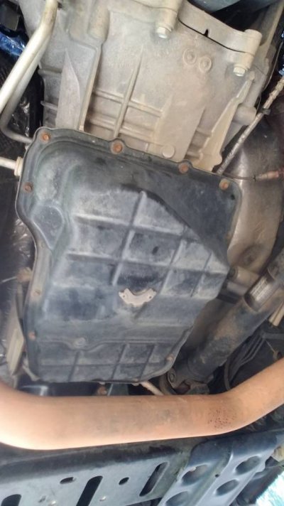

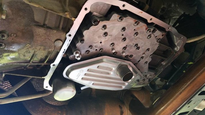

Well with my truck having 61,380 miles I figured it's time for fluid and filters change on my 66 RFE transmission.
I also wanted to add a drain plug for easy of changing later. I welded a plug in.
I'm currently typing this up while waiting on RTV to dry because dummy me used the Permatex Automatic Transmission Gasket Maker #81180 and it states to wait 24 hours to fully cure before filling with fluids.
That will be 12:30 tomorrow. lol
I'm glad I decided to do this as the factory fill was quite dirty and dark. It didn't smell much different than the new fluid but it was dark.
I let it drain for about 3 hours with the filters out with the front of the truck slightly higher than the back.
After I had everything put back together I measured exactly how much fluid had come out. To my surprise it was 10 quarts. To my knowledge the transmission only holds 12 quarts total. I was only expecting 5 or 6 quarts to come out.

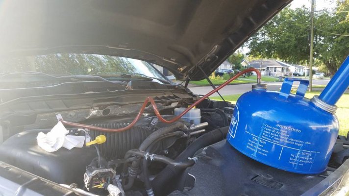

It's a good thing I bought 10 quarts of Super Tech ATF4 which was all they had at Walmart when I went about a week ago.. I figured I would have about 4 quarts left to put 2 quarts in my transfer case but I guess I will wait till tomorrow after I fill transmission so then I can go buy 2 more quarts for the transfer case.
Here are the pictures I took. The drain plug worked out great. I plan on draining what will come out every 10,000 miles and filling back up and then only cracking the case every 60,000 miles to change the filters.d787958c36fb6fb38619d2d307b4bd4a.jpgced0091d158195be8fc0994d58f9fc67.jpgb6145da7af1db5985c1f8d61856b8347.jpg70418bc1c679552cc4dff5db0cd11cf4.jpg7e1f0eed35eaeca4044849926330c2f2.jpgc5f28a97eb359891c5e1cdebcb7e4ea5.jpg4d2daafe6bf82413391c02c23913f817.jpgef0a44f910d16e70d6814b0b0e4979bd.jpg8ec97d21285f3ce5c4030740c6753f4f.jpg

The factory fill on a 66RE is 17.6 quarts which includes the torque converter. You will never get all 17 quarts out of it unless you perform a power flush or fluid transfer. In a typical driveway drain I've seen anywhere from 6 to 12 quarts. You must've let it drip for quite a while.
Disregard the color of ATF series fluids. ATF is dyed red (as most transmission fluids are) and Chrysler service manuals since at least 2003 have a statement as such. Although yours looked pretty dark in the pictures, I can tell you ATF+ degrades in color over miles in the RE, RH and RFE series trannys. Engineers tell me that moisture is the primary general cause of discoloration.
What is far more important is the smell. A burnt odor is a sign of clutch or transmission overheating. A small degree of gray silt in the pan is normal. This is material from the clutches, the more miles the more you'll see.
I use the Mopar MS-GF-44D Gear & Axle RTV (82300234AB). In 70 degree weather it sets up 10-15 minutes and can take fluid as soon as the pan is reinstalled and tightened.
