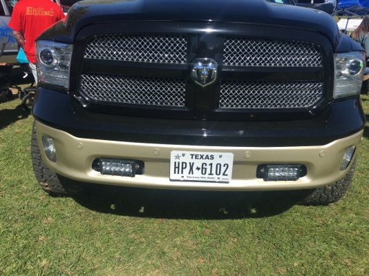

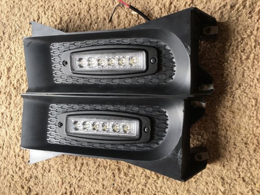

Toyed with this idea...
Each has about the same output as a LED pod
flush mounted LEDs in the tow hook area

That looks legit. Hmm i need to figure out how i can mount mine like that. They have these big side mounts noy ideal for this situation.

Guy i know did this, made his own brackets that are welded to the sub frame behind the bumper

Your great help! Thanks for a pictute of how it would look. Now i just need to figure out mounting
I wouldn't mind seeing a link to those 6" strips in the tow hook blanks you used. Are they adjustable/aimable?

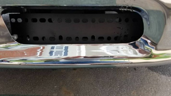

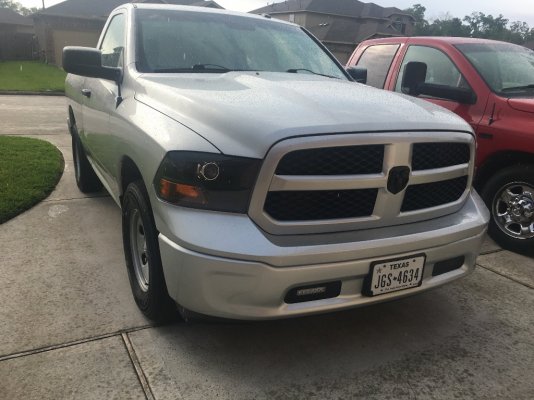

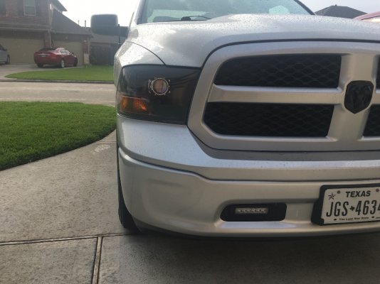

Here's how I installed mine on a 2013 1500 ...
Pt1f351600a76cb52ef30765706c33b49eb.jpg495220dc6141dba428075ee5ed30ebcf.jpg08c36914dd5360de640f4bcd7de8ffdf.jpg4e09cd02e9da403ea0c64527e1f41ce7.jpg
Got the 4"x 36" slotted 14ga plate/strap from Ace Hardware, cut it to 13.5", painted it, and mounted it using 2 clips and bolts from the tow hook blanks...

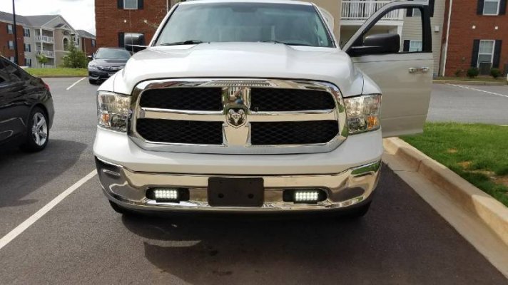

Part 2
20c116bb328022fe7d06e9543f86d4ad.jpgb445d55ba05760af6baff7c30ea3ead5.jpg3820ba99e4f082c80ff24331932abdd7.jpg0d347e4040fba68586bf50bd95a3842f.jpg
