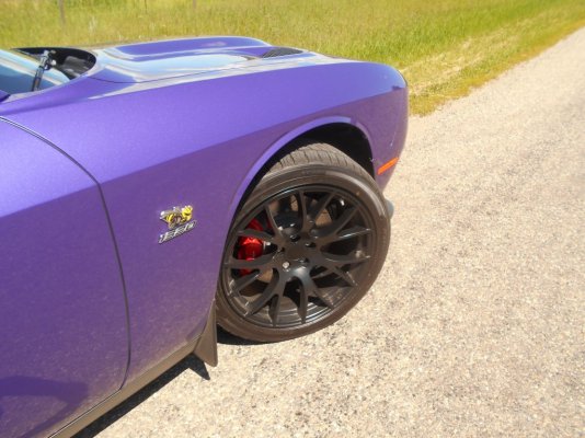

I know where there's one,but my wife might be a bit pissed if i sold it,lol.

Ha, someone’s paying a premium!
I only get to drive it when it needs gas,lol.She races it at the track more then i do,i'm more crew chief these days then anything, happy wife/happy life :Big Laugh:
