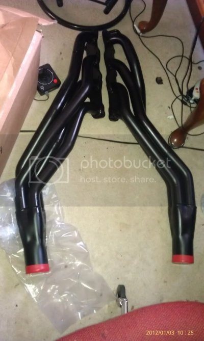

a big box showed up!

ahh i was gonna guess a bed rug...lol Awesome on the long tubes though

Congrads on them. Only two things I had to do to mine was open up the top hole front of the pass side and cut the trans tab on the passenger side. The front o2s will bolt in, get extensions for the rear o2s. Also if you haven't order some Mopar gaskets.

Thanks. Already talked to Truckin about everything. Last things i need to get are the gaskets and extensions and gonna get grade 8 bolts. Gonna be about a month or so to get it done, just cause i cant afford to have my truck outa commision if i cant finish it all in 1day. But i can not wait till its on. I cant wait to start it with just the headers on. Ill get a video of that.
Im planninh on doing a small custom paint job or somthing on the headers. Was thinking of putting in silver, HEMI on each cylinder and one big HEMI right at the end of the LTs.

Ah you got the painted ones.... keep an eye on it once they are on for a while to make sure the paint doesn't chip off.

yep. wanted the other ones but ehh. was gonna put a coat of high heat resistant paint on first. thanks again for your help man.

Oh make sure you check the wheel alignment tabs mine were gouging into the header. Make sure the O2 bungs are pointed the right direction (on one of mine the **** is pointed straight up into the heat shield/floor board and I had to hammer out a baseball sized dent to get the sensor to screw in) and check the header clearance next to the trans lines.
