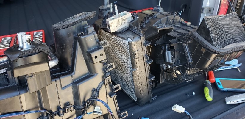

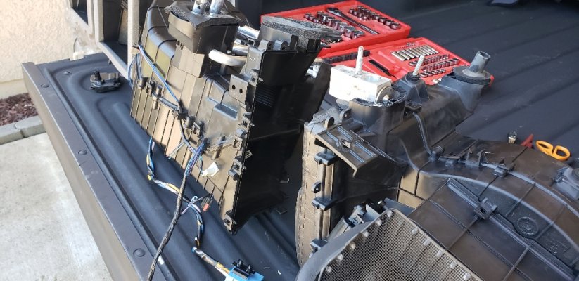

As stated the heater core and A/C evaporator are two separate pieces. It's common to have that smell in the cab of the truck if the evaporator core is leaking which is most likely your issue. The only part of the A/C system that's actually in the cab of the truck is the evaporator. The rest of the system is in the engine compartment. The A/C lines connect to the evaporator at the firewall of the truck. The dash will need to be removed in order to remove the HVAC box. Sounds hard but it's really not that bad. I just did mine to install Dual Zone temp control. This is a picture of the HVAC box separated to remove the evaporator after I pulled it out of the truck. 7ae4bcbbde4ab376f597f6fb67ad2f3e.jpg27535bb732c695229d794623709d7f9c.jpg

fyi-rock auto currently has a/c evap core for $28.00 closeout.me personally would replace heater core as well and check all blend doors and actuaters while you are balls deep in there.....

^^^ what he said
The stuff used to sealnup leaks in an AC system usually ends up plugging up parts of the system that shouldn't be.
Fix it the right way if you want a reliable AC system. The mechanic is correct to want to replace both the evaporator and heater core at the same time, even if the heater core isn't leaking. Most of the job cost is removing and replacing the dash and HVAC assembly, the only extra cost is the price of the heater core itself.
