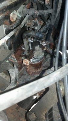

ok, got another question....after I disconnected the line to the filter, it still doesn't flow but a short line comes from a small unit from under the fuel filter. what is the small unit under the fuel filter? it reminds me of a carburetor bowl is it a lift pump?....filter?....it looks pretty messed up....dirty, rusty and probably hasn't been changed in awhile.

I think fuel pump similar to the Delphi lift pump. has a fuel fitting and tube that came up to the fuel filter. three mounting bolts I found a part number 05080885AA that seems to be it and a link to parts MODULE PACKAGE, PUMP. Fuel, Fuel Pump/Level Unit. DODGE # 68003854AB that lists it. that seems a little expensive and was wondering what aftermarket pump would work. I thought there was only one pump...in the tank. this is really similar http://www.autozone.com/autozone/pa...N-je5y9Z8vcz2?itemIdentifier=340425_971897_0_

here is a shot, the best I could get. removed the filter to be able to remove the clamps. like I said, in pretty rough shape. I think I should just get a new one once I can be sure of what to get.

Being I haven't been under the hood of a 24V more than a handful of times, I am not 100% sure what that is... You said it is directly underneath the filter bowl? The lines from there would go to the injection pump correct? That looks like the lift pump itself, which feeds the injection pump, but I may be wrong

I think youre pretty much on to it. it is directly below the filter and feeds into the filter via the one hose out of the top. I think as long as I have it apart, i'll go ahead and order one.....amazon has them relatively cheap. I know the tank pump/sender was bad because when I put the fuel back in, it registered....so hopefully if I can get it working by replacing that pump, ill be ok.....hoping the injector pump is ok...that would be $$. thanks for the input.
