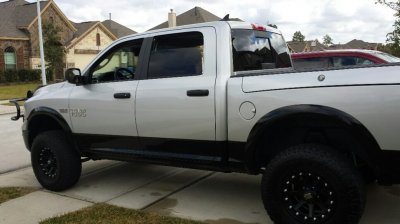

I recently bought a 14 crew cab used that already has some kind of lift. Is there a way to find out how much and if there is a body lift.

Measure the fender heights and post them here. Post a picture as well. For a body lift, look at the cab and box mounts for spacers.

How high does it look and does it have stock size tires? If it just looks a little higher than stock my 1st guess would be to look for spacers or aftermarket adjustable front shocks like the bilstein , rancho, or pro comps.

It does have fox 2.0 rear shocks I think taller springs and longer sway bar links and maybe rear track bar relocation bracket. stock shocks/struts in front. It looks like a spacer in front on top of the strut but just a guess. Hard to tell if has a body lift. Thanks for the quick replies Will measure asap.
Tires are 285/75/17 or 285/70/17 cant remember which one on XD rims

Id say you definitely have some form of lift. Spacers on top of the struts is a leveling kit. Crawl under and look at the body mounts, if you pucks in between frame and body its body lifted.
