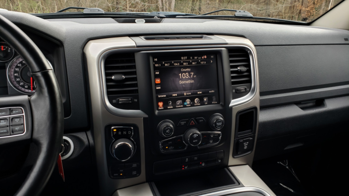

With my 2016 Ram, i seldom use the Radio Soft Keys
I have read that radio touch screens are finicky, so rather than take any chance of that happening, i use the knobs & buttons

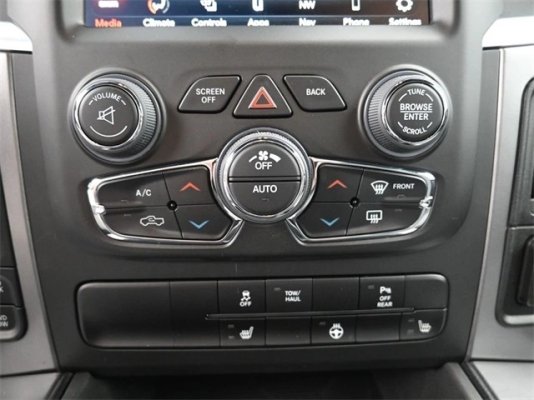

Have they replaced the part just below the Radio Volume & Tuning Buttons ?
I use the A/C controls below
on some vehicles, that unit goes bad
