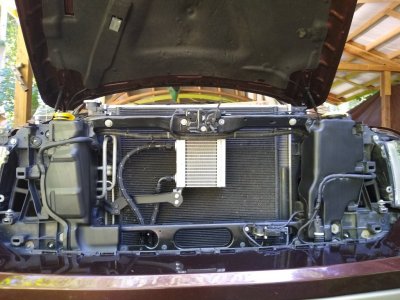

Well, I did the AGS delete today. I used the CFT Performance kit, $5.00 plus $7.00 shipping. As many people said, the instructions are pretty poor, but I was able to figure it out. This kit keeps the AGS motor in tact, so the modification is reversible.
I tow a heavy (9,000 pound) trailer, so keeping the temperatures low is great. I have no numbers yet though.
Before:
After... You can see the AGS motor in the lower right corner of the grill opening, this will allow much better air flow to my added engine oil cooler too:

I appreciate that the shutters do not cause much of a problem when in the open position. There is also the option to remove the middle shutters. One thing I do like about removing the whole assembly (besides the (minor) weight reduction), is getting rid of the fat center section that was shielding my engine oil cooler (if I knew better when installing it, I should have placed the cooler off center, oh well!).

I just towed my trailer for the first time since deleting my AGS. The oil temperatures were noticably lower. It did not get over 215F. The outside temperature was pretty low though, around 50F. The drive was somewhat hilly too. Glad I did the AGS delete!
