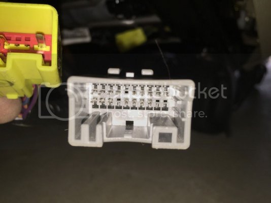

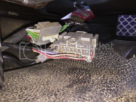

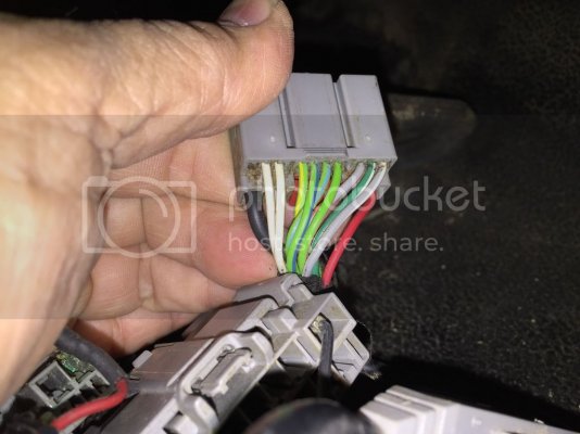

Adding my pics to the thread as I try to get 2015 seats working in my Tradesman ST 2500:
Here's what I have:
3 gray connectors that go to the center seat console
These I think I should be able to put these in a new gray connector to fit the 2015 seat:
and this is the gray connector on the 2015 driver seat:
Bummer they won't plug in directly :-(

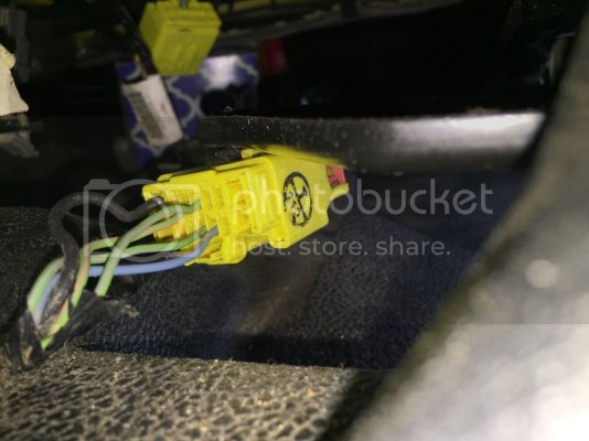

2015 driver seat Yellow connector:
2013 Driver floor harness yellow connector_5 wires:
2013 Seat 2 wires to side air bag, 2 wires to seat belt:
2013 Seat 2 wires to side air bag:
