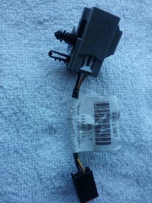

This is a picture of a truck that has the correct wiring. Your new seats will have the gray connector so you will need to source the plugs and pins. I have some on order but I haven't received them yet.
If I have these plugs already, then I'm heading in the easier right direction? I currently have a 2014 Bighorn crew cab, with heated seats, power driver, 8.4 nav radio. Checked today and have the plugs shown above. Was debating about doing Katzkin covers, but would really love to add factory leather seats that have pwr, heat, and cooling.

well guess that was a fail, it didn't quote the picture. From page 9 post #87 I believe it was.
Yes your wiring is correct for the heated/ ventilated seats. If you install the seats it would be Plug and Play. You would need to add the proper switch panel and possibly add the codes in order for them to work. In some cases the ventilated seats for work without the adding codes but they will not show up on the radio screen you can only use the buttons on the switch panel. You can also purchase an OBD Genie to add the codes and have everything function as if it was factory.
