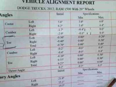

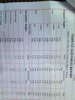

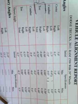

Here are my before and after specs if that helps...

I have the rear adjustable panhard bar but the issue is with the front. BTW sorry for the crappy/sideways spec sheets. Let me repost

Camber was -1.7 on the left and -2.0 on the right. They were able to get it to -0.4 and -0.3 which is within the normal range. So I'm figuring they were trying to sucker me into buying crap I didn't need. Truck drifts/pulls a tiny bit but overall decent considering.
