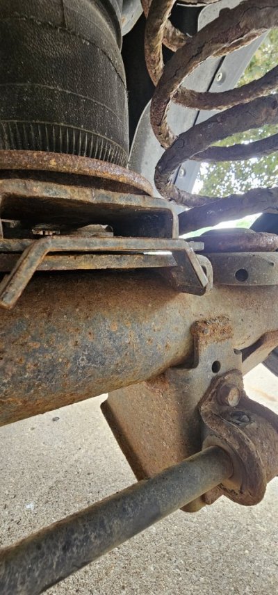

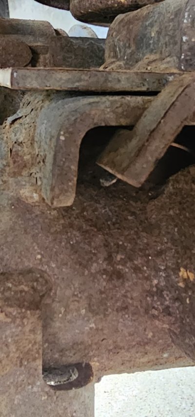

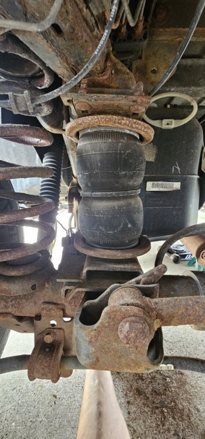

Is it normal for there to be a gap between the truck and the bottom plate of the air bags? The plate has 2 hook brackets on one side and carriage bolts on the other but with my truck sitting on Jack's, there is a sizeable gap between the 2.
Im looking for a clunking noise that has been coming from the rear of my truck and im thinking I've found it, is this normal? Is welding the air bags to the truck an option or suggested? And why does my driver side bag look crooked?1000011846.jpg1000011844.jpg1000011841.jpg1000011843.jpg

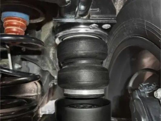

I should have looked up better before replying. Lol I did a quick Google search of them to see what they were and replied. After my message, I went to see which ones I would need and looked at AIR RIDE's site.
So with these cradles, it leaves the air bags suspended similar to the jounce bumpers?... thats neat. I'd have to make sure everything is installed straight and square then hey? So when inflated, it's positioned correctly in the cradle. Screenshot_20250616_175554_Chrome.jpg

It will eliminate the bottom plate on the bag all together. No need for bottom bracket or plate. When you install the cradles the bottom of bag will rest on cradle allowing the bag to lift when needed. As bad as the rust looks I hope you able to get the bottom plate off without issue. To me it looks as if whoever installed them in the first place was trying to do what the cradle is for but not smart. You are probably hearing the plate smack the bump stop pad.

Oh and they won’t be suspended like the picture when on ground. They will rest on cradle like normal but not attached to anything. Hope that makes since.
With the suspension fully extended like that, it's the arc of the panhard bar that causing the driver's side of the axle to swing twords the passenger side.
