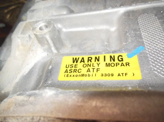

What aftermarket trans fluid do you recommend for an Aisin HD transmission?
Bike_Pilot
Mar 1, 2023
35
29
Colorado
I use the OEM spec Mobil 3309. It's what the trans is designed for, is relatively inexpensive, and they lost forever.
John Jensen
Mar 27, 2016
1,582
1,770
San Diego County
Ecodiesel
I use Mobil 1 ATF 3309 (Reported to be the same as Mopar ASRC 05189966 )
Options:
AISIN ATF Type T-IV
Valvoline Maxlife ATF
Castrol Max Synthetic
