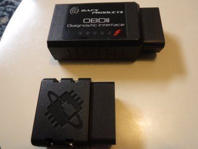

Also, I was just getting ready to purchase the, BlueDriver Bluetooth Professional OBDII Scan Tool for iPhone, iPad & Android
Does/Is the OBDLink MX anything alike? Assuming this can change a lot of those options, where the BlueDriver will not? Or will it?
Should I go ahead and get the OBDLink MX then instead? Is there better functionality?

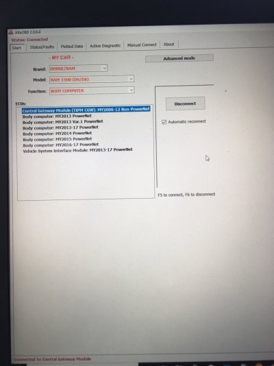

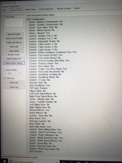

So I’m connected via the OBDlink MX and have AlfaOBD open and connected but no option to change anything. Am I doing something wrong? PC version btw.
2009 QCRB 4WD - 4.56/Shorties/FMTB/Intake/Exhaust/6” on 35’s/lots more [emoji41]
lpennock
Army
Nov 17, 2018
576
446
Phoenix, AZ
5.9L & 6.7L Cummins
Try the active diagnostic tab.
Then there should be a configuration change option at the bottom of the page.
I bought Obdlink MX, I'm not familiar with blue driver. You also have to pay fifty bucks for the Alpha app. I had a cheaper OBD adapter and I couldn't get all the functions to work. Quite frankly, most of the things I can, change we're already set.

@Focker thanks, I think i'm going to order the OBDLink MX and try it out.
Do you know if it will only work with one vehicle at a time? (Married to one vehicle). Example: I wanted to use it to pull codes from another friends vehicle.
I will definitely post and share my experience with it after I get it.
lpennock
Army
Nov 17, 2018
576
446
Phoenix, AZ
5.9L & 6.7L Cummins
I've used my mx+ and AlfaOBD on 3 different FCA vehicles. The MX should work on any OBD2 vehicle.
