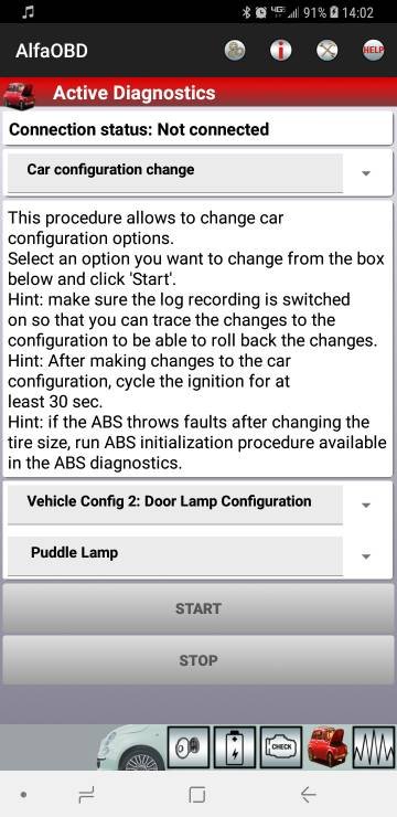

Sorry, I misspoke. The option to turn the lights on is in the BCM. 533d6b4c56ce4cf87945511864da5b0e.jpg
Sent from my SM-N950U using Tapatalk
Ok I turned that option on but still no puddle lights, I suspect the lights are bad. I also have a dim turn signal LED. I will pull the lights out and test with a multimeter to make sure they are getting voltage. Thanks for the reply.

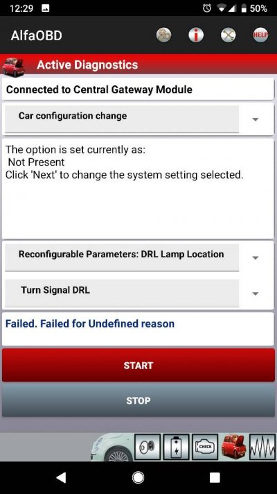

pcabe5
Mar 30, 2019
US
2009
6.7
Turn the key as far as it goes without starting the truck. This is called the Mar position.
Open AlfaOBD and complete the connection process.
Then...
SELECT CAR MODEL:
RAM 2500 (DJ/Dr)
SELECT FUNCTION:
BODY COMPUTER
SELECT CONTROL UNIT:
Central Gateway Module MY2006-12 Non-PowerNet
Select procedure to start:
"Car configuration change" (last option at the bottom of the menu)
Select option:
Reconfigurable Parameters: DRL Configuration (Set this to Canada)
Then...
Reconfigurable Parameters: DRL Lamp Location (Set this to Turn Signal DRL)
Exit the app.
Remove the key.
Start the truck.
Put the truck into R or D.
Enjoy the DRLs.

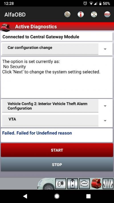

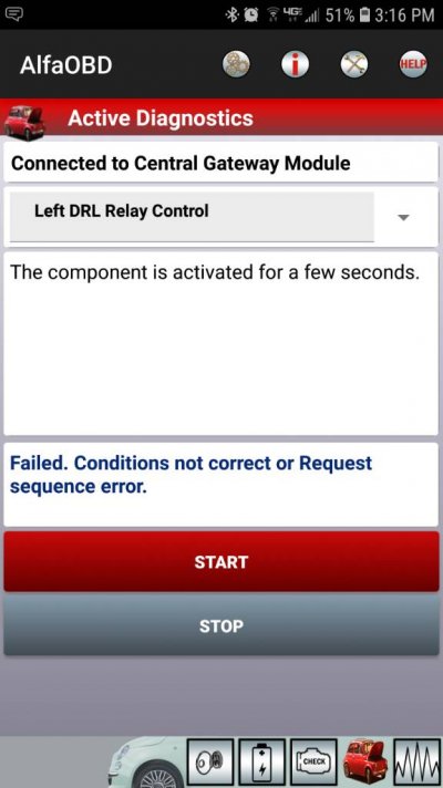

I bought an obdlink mx and purchased the alfaobd software but I cannot do this.
I can test lights and other functions, for example turn on left low beam and I can change the user defined parameters such as headlight delay, etc. I cannot add rear camera or DRL's. Gives me an unknown reason fault.
Any suggestions? 2009 3500
