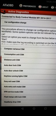

I set mine a week ago and still have nothing in the evic or radio. They are working though I can see them in the reflection of other cars ahead of me.
Did you set these?

Ok so I’ve been on the road for a few weeks the truck has sat for the most part with a few uses by the family and still no DRL option in the radio... I have officially given up...
I also have a 2014, below are the 6 settings I have set using Alpha and I had the option show on both my original 5" radio and my current 8.4" radio.
CBC Features Configuration:
  • DRL Configuration: Optional DRL
  • DRL Lamp Location: Turn Signal DRL
  • DRL Dropout Enable: Set
ECU Configuration 3:
  • DRL customer setting enable/disable: Set
Customer Programming Features:
  • Daytime Running Lamps: Set
Vehicle Config Customer Settings Menu 1:
  • Daytime running lights customer settings menu: Set
-Keith
