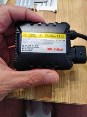

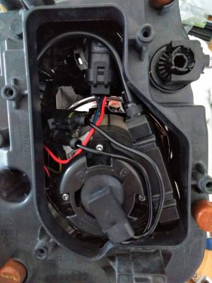

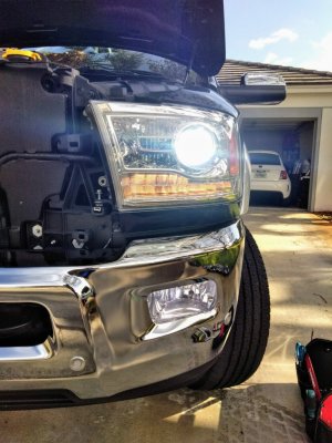

So I wanted to blow $30 and "test" the "Enable High Intensity Discharge Headlights" toggle in the Body controller. So I bought the absolute cheapest set of bulbs and ballasts with no harnesses, capacitors, resistors or other "smoothing" devices. What I bought was the worst of the worst crap -- just to see if the $300 kits from all the fancy RAM vendors are now 100% unecessary for compatibility reasons.
My preliminary findings -- The $300+ kits are now unnecessary with alfaobd.
My simple test -- find a ballast small enough to stuff in the case and close the dust cover without modifying. No cutting, grommets, mounting, etc... Just shove the stuff in and call it done.
It works. It just works. You can go with any cheapie crap HID kit (AND take the inherent risk that the ballast will fail in 6 hours, LOL) and run with it if you choose. I'm attaching pictures -- very basic.
This is something I would have never thought possible with a 2013+ RAM truck.
I really don't think the fancy HID vendors with their "5th gen super GT can-bus" ballasts (roll eyes), super duper wiring harnesses (that look like something from the dark ages), capacitors and resistors want us to know that for $49 worth of software we can shut down the bulb out checking (by enabling High Intensity Discharge Lights) and just run with it. That would really take a bite out of their business model.
Something to think about. Alfaobd appears to be a game-changer for the HID market itself (NOT just LED's).
Sure you can buy the expensive kits for their inherent quality -- where it exists -- but not because you HAVE TO BUY them to circumvent PWM and Circuit disabling -- any more!
I do have one question for my LED headlight friends -- we know enabling LED on the other circuits (FOG, Reverse, license plate, etc....) disables PWM. Does it do the same for the LOW-BEAM circuit? OR does "enable High Intensity Discharge Headlights" disable PWM AND bulb out resistance or JUST bulb out resistance? If it's the latter, I'd do them in tandem and be sure that PWM isn't hitting my ballast... If I had LED bulbs to test, I'd set it for enable High Intensity Discharge Headlights but NOT enable LED Low Beams. Then run the LED's and view through my phones camera photo-sensor and see if the LED's are cycling. IF they are, those with HID's might want to do both to be sure that PWM isn't still hitting their ballast even though the HID setting has turned off the bulb out warning.
-Guzzler

Damn that looks good!! Always liked HIDs better they're brighter than LEDs just nit as reliable
-Guzzler

Awesome recon! Do you have links to the set you purchased?
I really can't recommend them as one of the ballasts failed about 15 minutes into initial burn-in. I was just going for some very small / cheap test mules.
The bulbs were fine -- although they had a greenish tint that wasn't supposed to be present.
Here are the links:
Ballasts (pair): https://smile.amazon.com/gp/product/B06ZYSFW3J
or individually: https://smile.amazon.com/gp/product/B009MVK0KI
Bulbs (pair): https://smile.amazon.com/gp/product/B07G7TNVQ6
-Guzzler
