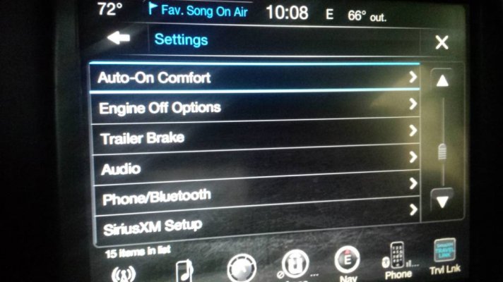

Factory. And I have searched and searched and have yet to find someone that was able to change the trailer name with the 8.4 Uconnect? Everyone complains about it because it says you can do it in the manual?
Have you come across a fix for this issue?
I just installed the OEM brake controller. I can see the controller on EVIC, but nothing on the 8.4 screen. I've enabled and double checked that the 3 trailer CSM's are set to "YES".
Not sure how to get these menu items to show up.
Ricks Ram
May 1, 2015
4,411
3,388
Are you looking on the settings menu on the radio? Sorry if you have checked there just wanted to make sure. If you have already checked I reccomend letting the truck sleep for at least a day if you haven't already. The UAS and UAQ radios take a long time to show the codes when they are added. 0cea31f5ae8bd822e8fcc295029e3f9f.jpg

I just set the "Trailer Name CSM" to Yes and it has been working fine. Not sure why you are not seeing it?
