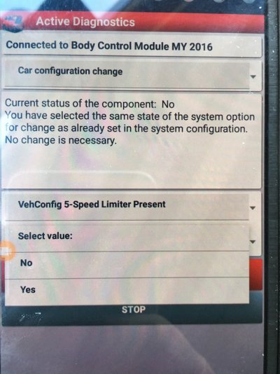

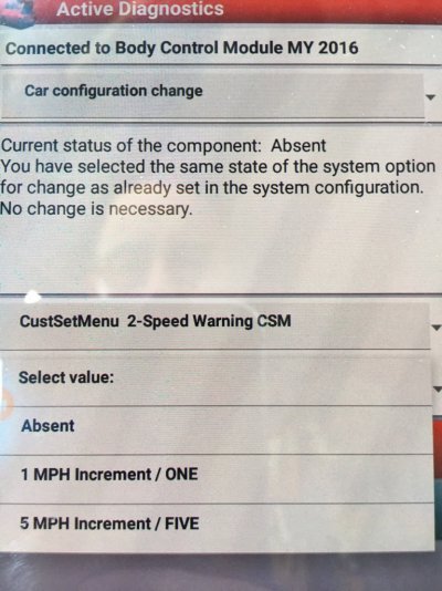

Could be one of the following...
Vehicle config 5 / Speed Limiter Present
Speed Warning CSM (this could be related to the above and if enabled might show on the 8.4 under settings and safety and driving assistance?)
Edit: Careful when changing some settings. Not sure I would mess with the country of origin? Take plenty of notes and upload a fresh copy of your BCM to Google Drive before making any changes.

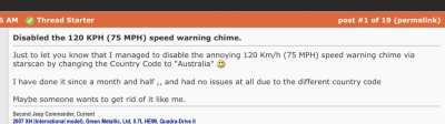

thanks, i know that i must be carful...
this is what i found in another forum. i also found another post on a french forum, saying that it need to change country code to UAE, delete this option and set again the country correctly.
In the alfaobd, do you see the actual (before change status) on screen or do i need to check in th blog before?
Hmm... Speed Limiter is set to "Not Present" on my '14 1500. And I don't appear to have a "Speed Warning CSM", at least not that's in the BCM log I have saved. Might be something they added in later years.
