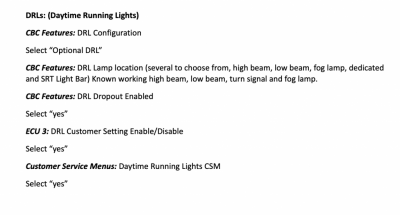

There is only one setting for country code that I am aware of and it is in VehConfig 1. Not sure if you would need to set the country of origin or just optional in "CBC Features - DRL Configuration" (No DRL, Canada DRL, Europe DRL, Optional DRL or Europe DRL 48.04)??
However, seeing as you have a Limited, there are instructions here listing the procedure for setting Dedicated DRL which I would think you would want.
CBC I/O right dedicated DRL Lamp output preset - YES
CBC I/O left dedicated DRL lamp output present - YES
CBC DRL config -OPTIONAL DRL
CBC features - DRL lamp location- DEDICATED
CBC features- DRL dropout enable- YES
CBC features LED dedicated DRL present- YES
ECU Config- DRL customer settings enable/disable- YES
Daytime Running light CSM- YES
https://www.ramforum.com/posts/1959214/

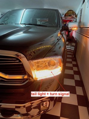

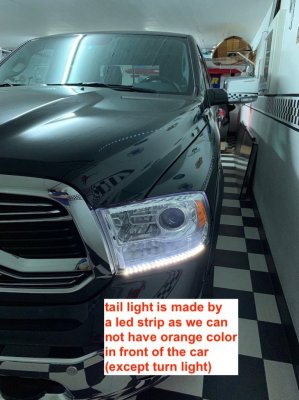

those instruction are different from the one i have taken from you list of working setting.
Here we have to modify the front tail light as orange light in front is not ok. they glue a led strip at the bottom. you can see on the picture. i just want to have the "regular" front light (not high beam) on.
i think a just need to change the CBC feature - DRL lamp location from DEDICATED to LOW BEAM DRL or even to FOG LAMP DRLIMG_0805.jpegIMG_0802.jpeg alfaobd DLR.png
