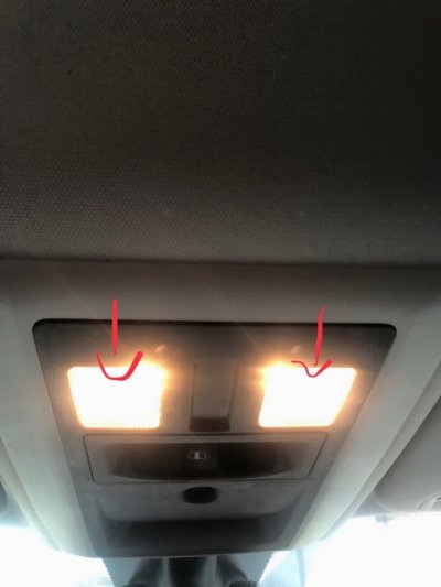

How did you change the front ones? Do I have to get the led one for them to be led? 98e55e206b32152d7b9d38bd4b263bf8.jpg
Nope. Use a small flat head screw driver or a small plastic trim tool. Gently push in and down and they'll pop out.
Thanks.
