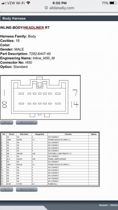

Was this what you were looking for

That's exactly what I wanted, that and window plug, but that says unavailable, unless I'm reading it wrong.
Any info is greatly appreciated, thank you all.

I'll do a little more digging and see what I can find

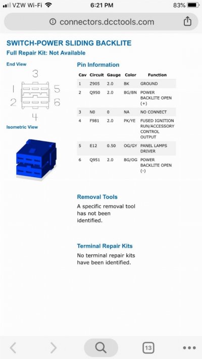

This is the correct connector. We were able to find the part# but we were unable to find any that were available when we did ours a few years ago. We just tried to find the actual window switch with the pigtail still attached. You never know the connector may be available now but it definitely wasn't then.

It’s still coming up empty. All of google doesn’t even recognize that part number, or that number by itself.

I was able to source the actual window motor repair kit so I had the correct connector for it but I was never able to find the actual connector for the rear window switch itself. I ended up getting one off of a wrecked truck off of eBay and built my harness from there.

Thanks everyone, that's the direction I'll end up going, as soon as I find a donor.
